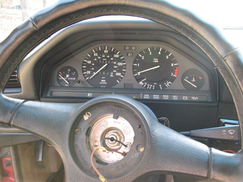

    I was going to paint my needles red, but was wondering how the paint affects the reflection properties of the needles. Since they are not backlit and use the light shining on them from the front for illumination at night, I wanted to know if painting them will cause them to not light up well at night or not. Also, when the tach and speedo reach a vertical position, the light fades away towards the end of the tip, do these effects stay?
    Here it is stock, I'd like to paint them red but if it is going to ruin the reflection quality at night, I don't know if I will.

      As they rise more vertical, the lite starts to fade away more and more, personally I think it is really neat.

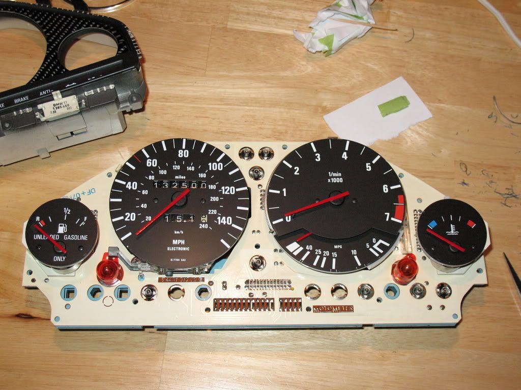

      I have a spare cluster that I had to use for parts, it is a Moto Meter tho, mine is a VDO, I remember the tach did not work when I installed it before using for parts, I wonder if the speedo will for testing? Actually either way I could still play with the needles and lights to see what would happen... but has anyone done it already?

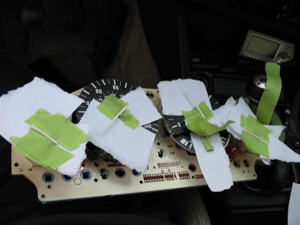

                          I have painted needles in a flat red color and they work just fine at night. I actually pulled the needles off the hubs and stuck them on toothpicks to paint them just so there was no chance at all of overspray.

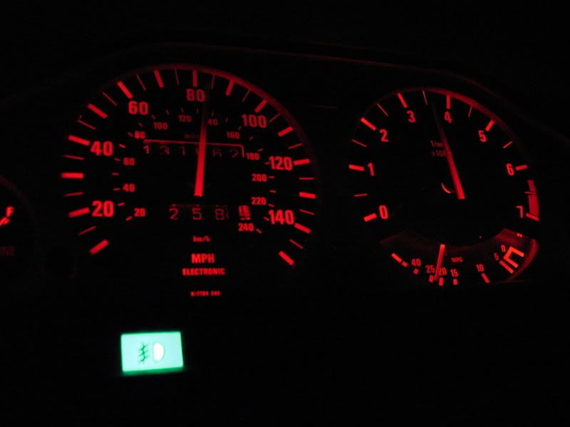

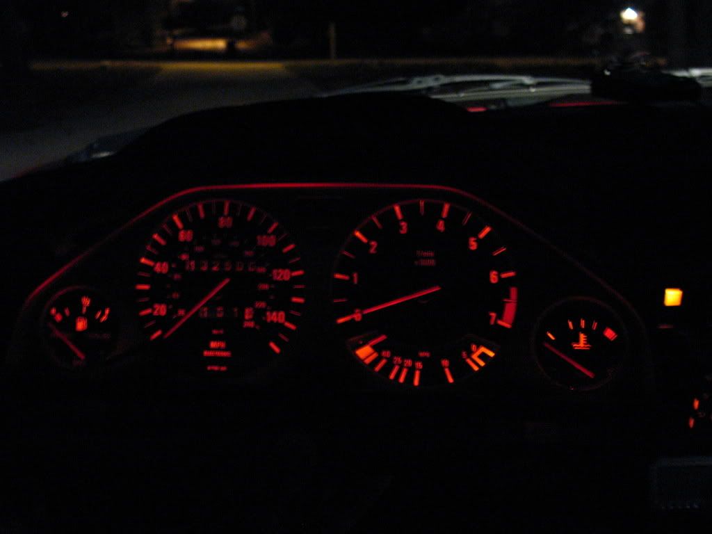

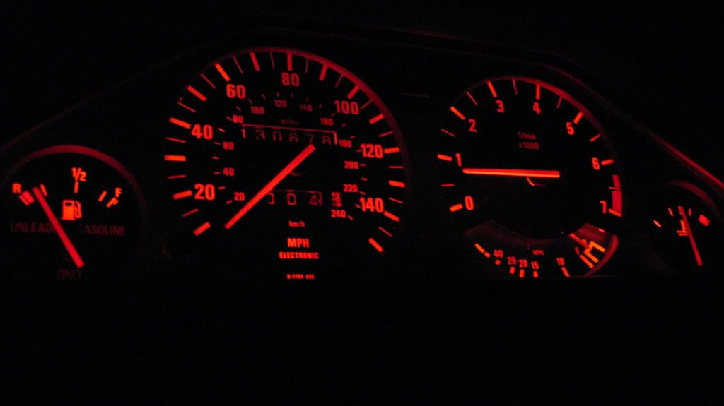

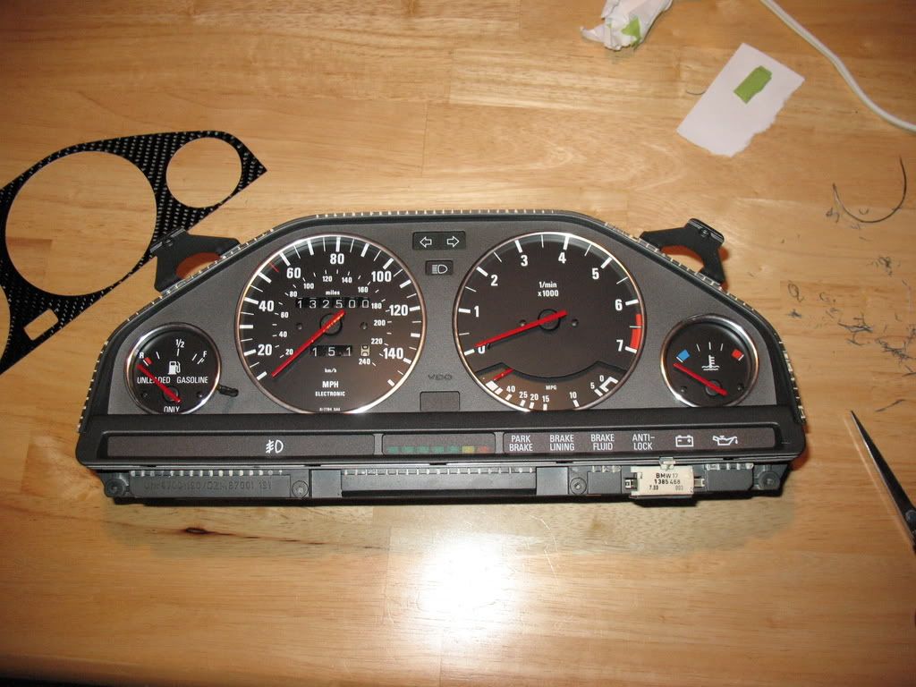

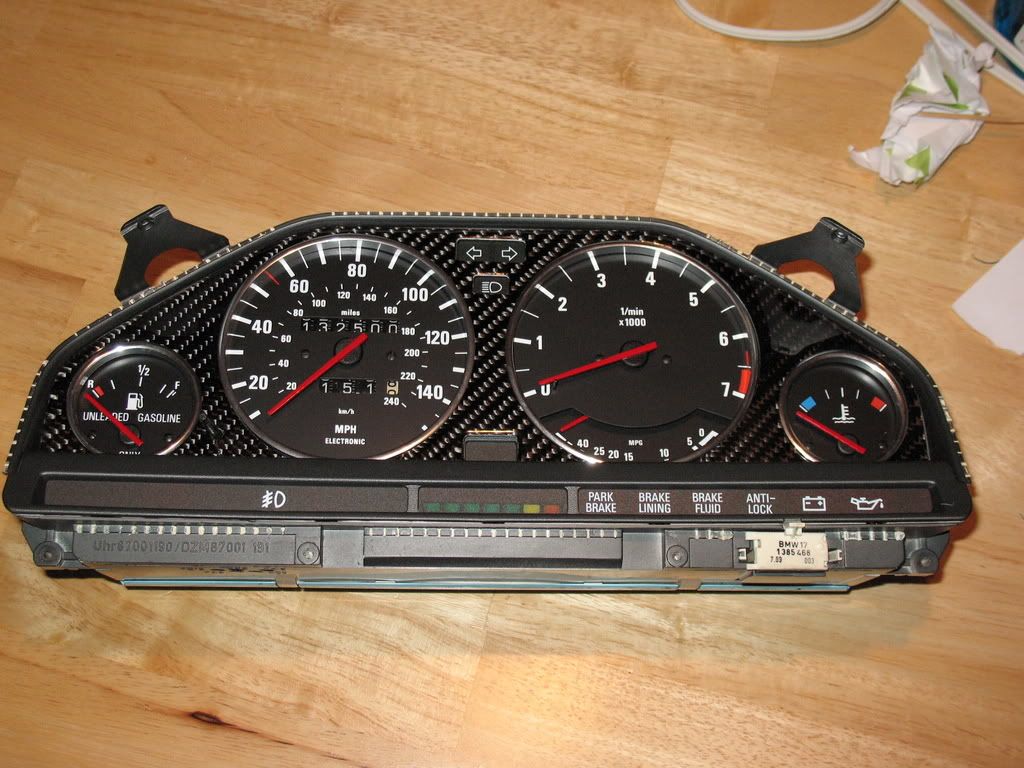

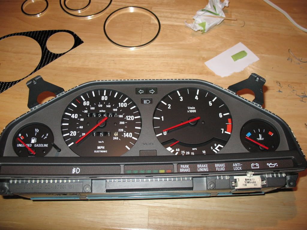

                            Well, they have been painted.... and... upon backlight testing, it's a success! They light up nice at night, appearing a bit darker both in tint and brightness then the rest, but still ok. I did not drive the car, but I moved the needles by hand and they still have the same fading properties when they move vertical. The cluster was not fully built up, so I had to hold the halves together. The carbon fiber overlay had to be trimmed, still need to finish it up, and the trim rings are not fitting very well, the big rings seem to be a hair on the small side while the small rings are going to require the holes to be opened more, thats going to be alot of fun :roll: Plus, they sit too low, normally the gauges are flush against the back, but if the rings are installed all the way like they should, it would interfere, so I am not sure how I am going to fix that.

                              Some pics so far...
                              Too much plain black and white, wait thats an 80's Michael song...the 80's were great for lots of things... Safety Dance, KITT, me, E30's etc.... but blah gauge clusters? Nah... time to kick it into the.....2009's....yeah...
                              Crude, yes. Works, yes.

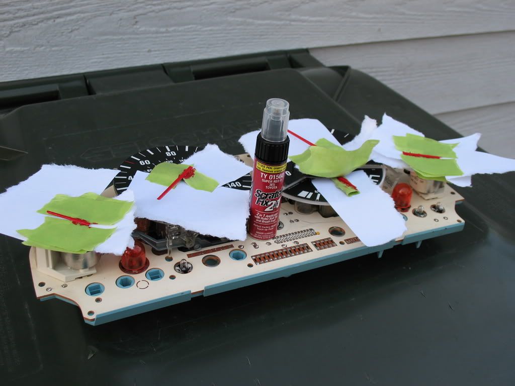

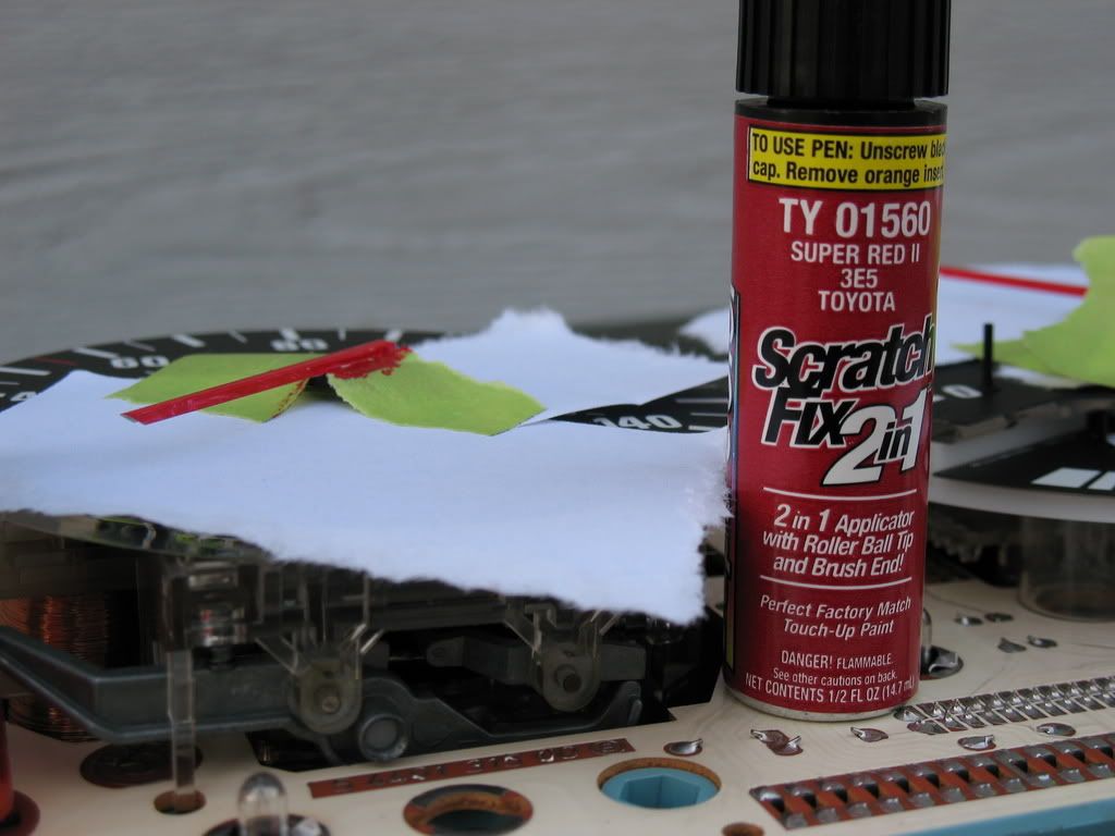

                              I decided to go touch-up paint route. I figure if I am going to spend $7 on the darn thing, may as well be touch up paint that I can use on the car, so I looked at the selection from Advance Auto, and found a color that (I thought) matched - Toyota Super Red II. As soon as I got home and opened it, it was way too brighter and red-er. red for the car... I was a little disapointed, but then when I got to thinking about it, I bet it would be really nice on the gauges... so I went for it. This is after 1 coat, they got a total of 3.
                              Playing with the overlay (still needs work) and trim rings (still needs work)
                              So I took the cluster out, no plastic cover or anything, and it wasn't screwed together so I had to hold it with my hand... I had a hard time getting good pics as I had a longer shutter speed and was having a hard time trying to hold the cluster up, and the camera still, as such, I was unable to get a picture of the needles at a vertical position.
                              Overall I am *very* happy with the paint, I am excited to see them dance around now. I thought about leaving the econogauge white, but all the others would be red, so I wanted it to match, plus I think it'll look cool. The carbon fiber overlay is being a real pain tho trying to trim it correctly, and I am gonna have to spend some time with the trim rings to see how to get them to fit.
