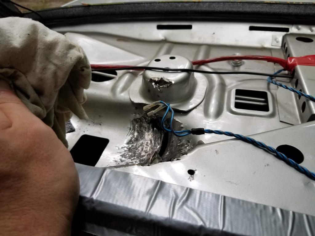

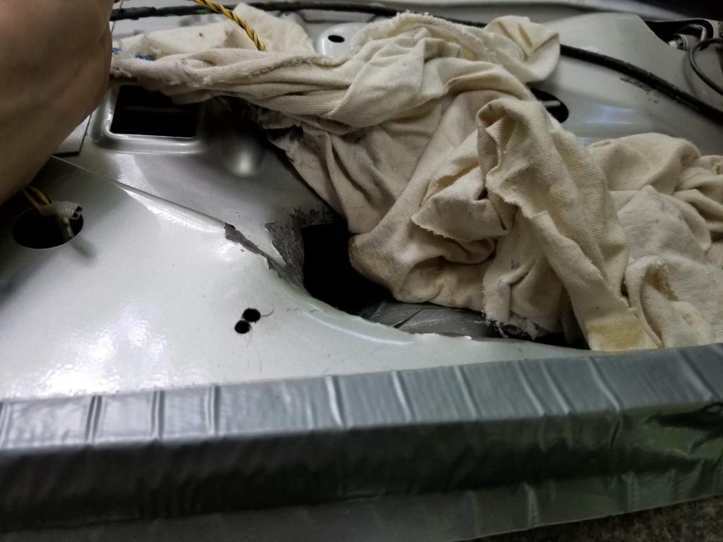

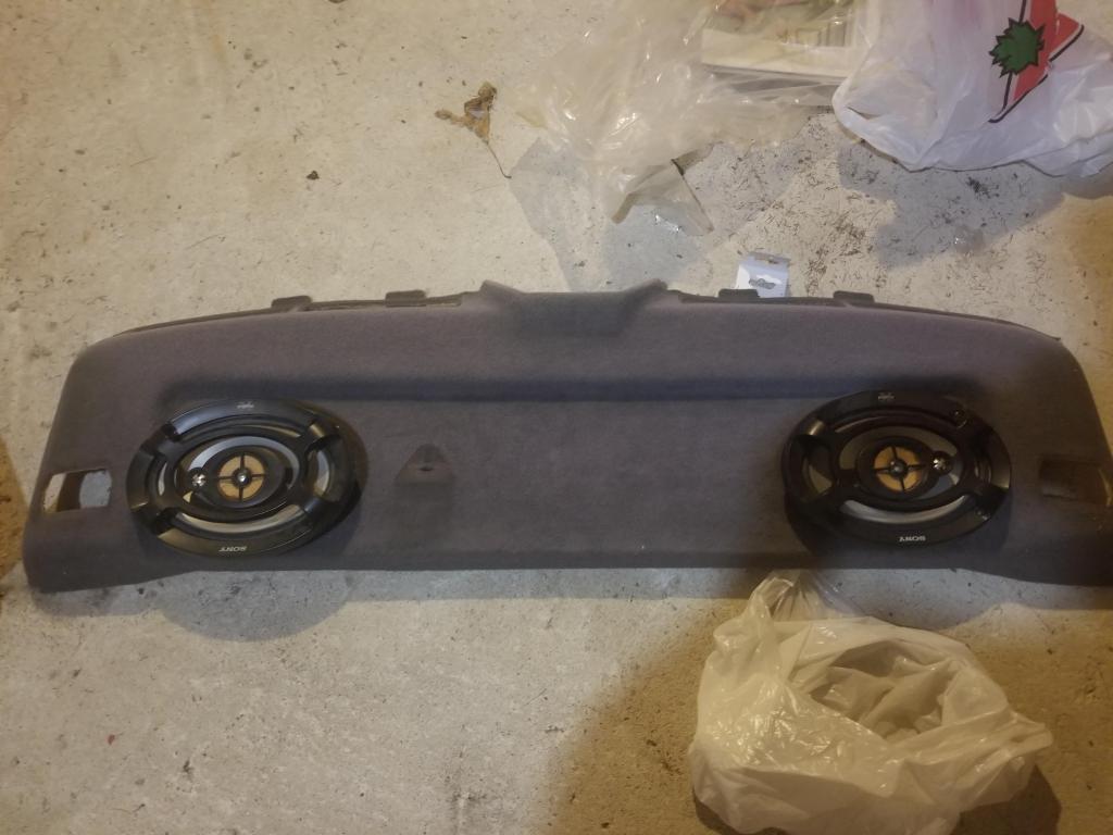

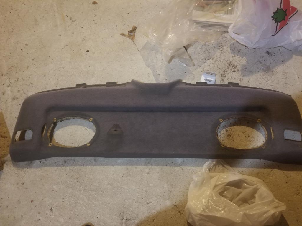

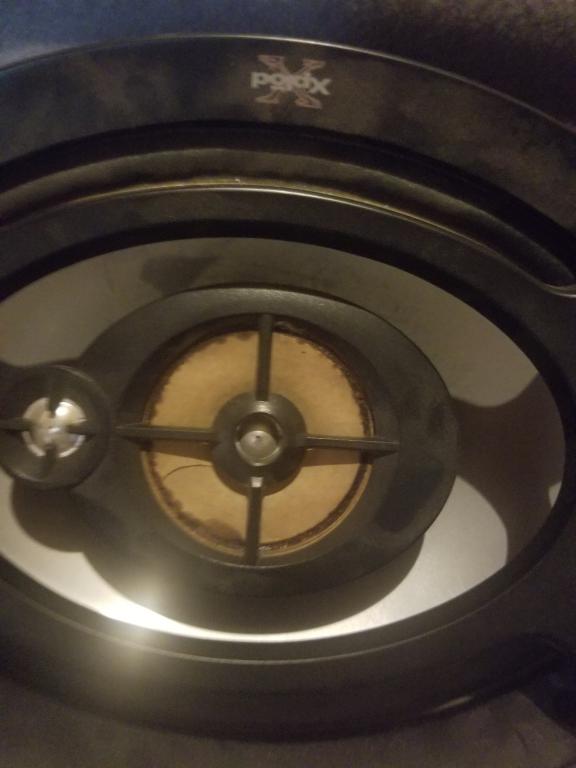

    Swap and Paint Rear Deck
    Thought I'd share my experience with swapping out the rear deck and speakers to return it to an OE look. Sadly the previous owner did a botch job an installed some fugly looking speakers while also doing damage to the frame

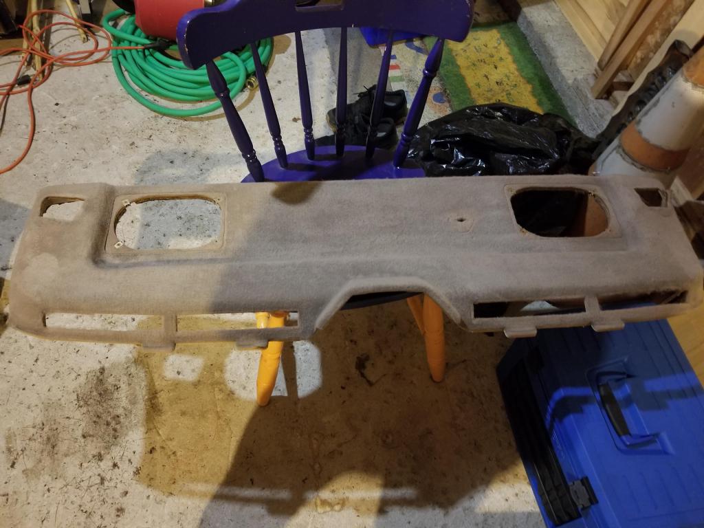

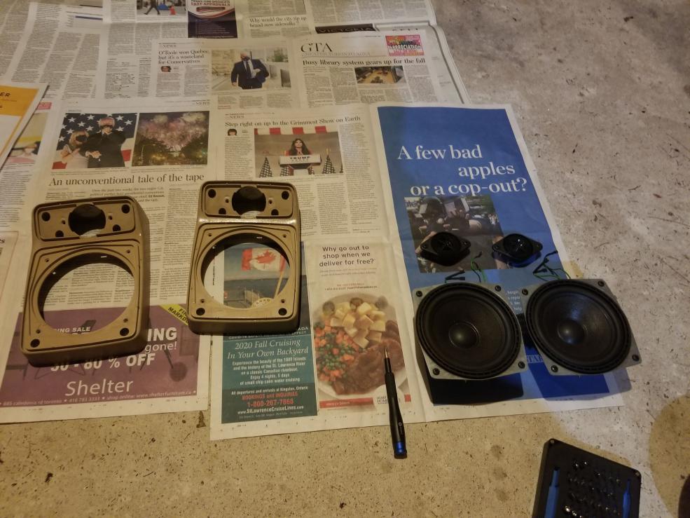

    As you can see it was time to give the car something better. I got lucky and found a pretty good deal on Kijiji in Montreal for a tan rear deck and premium speakers so I made the trek down.

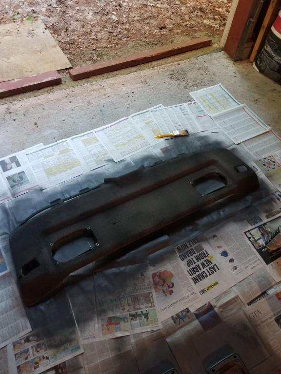

    Here's what it looks like before I painted it.
ID:	9949825Click image for larger version

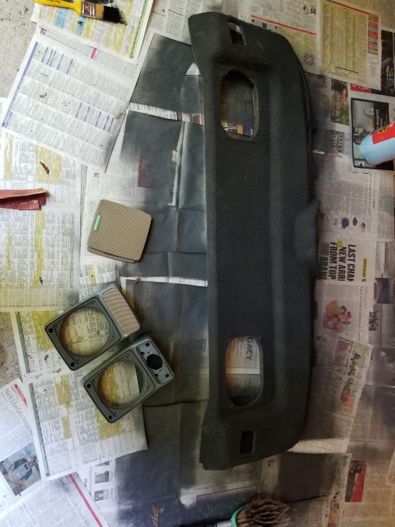

    After a clean, I used Dupli-Color Vinyl & Fabric Paint Charcoal Grey for the deck (ended up using the whole can) and Certified Deep Grey Automotive Spray for the speaker housing and grills.

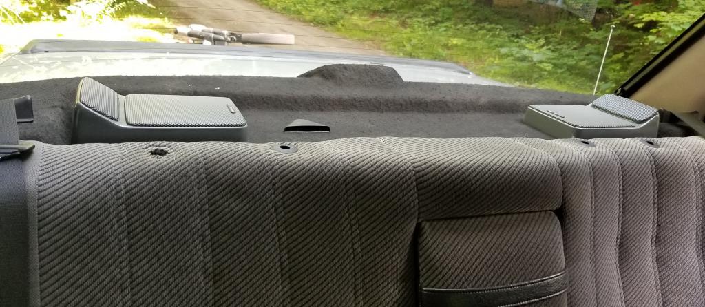

    Here is the final result with it in the car
    All in all, pretty happy with the results

      How many coats
      • onesecond
        • Apr 2018
        • 159
        For the back tray I think it ended up being around four coats, I just ending up emptying the can. For the speaker housing it was about two and a half (touch up areas) and one and half for the grills
