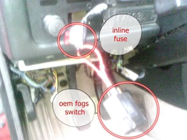

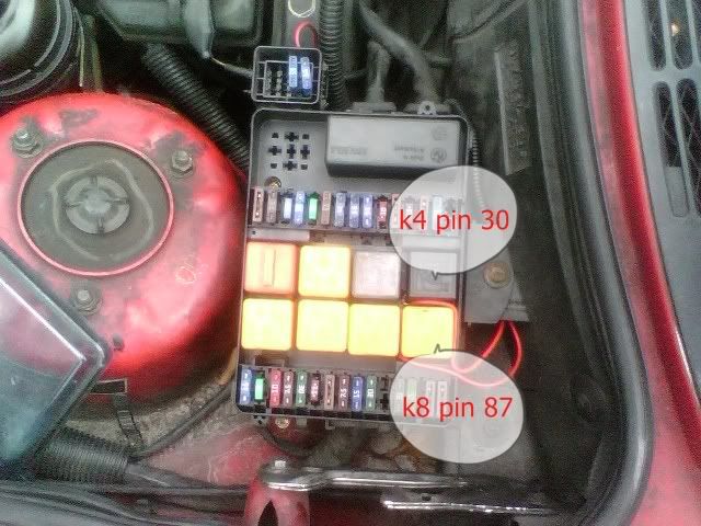

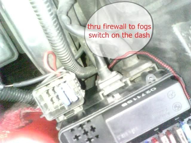

            Bro the only way I can do it was running 2 wires from the relays , 1 wire from k4 relay pin 30 and the other 1 from k8 relay pin 87 and connecting both to the original switch with a inline fuse , this way you can run the fogs even with the key out , I'l post some pics later (sorry about my english I from cuba)

                    here is how i do
                    sorry for the cell pics
                    results , enjoy it (on even with the key out)
