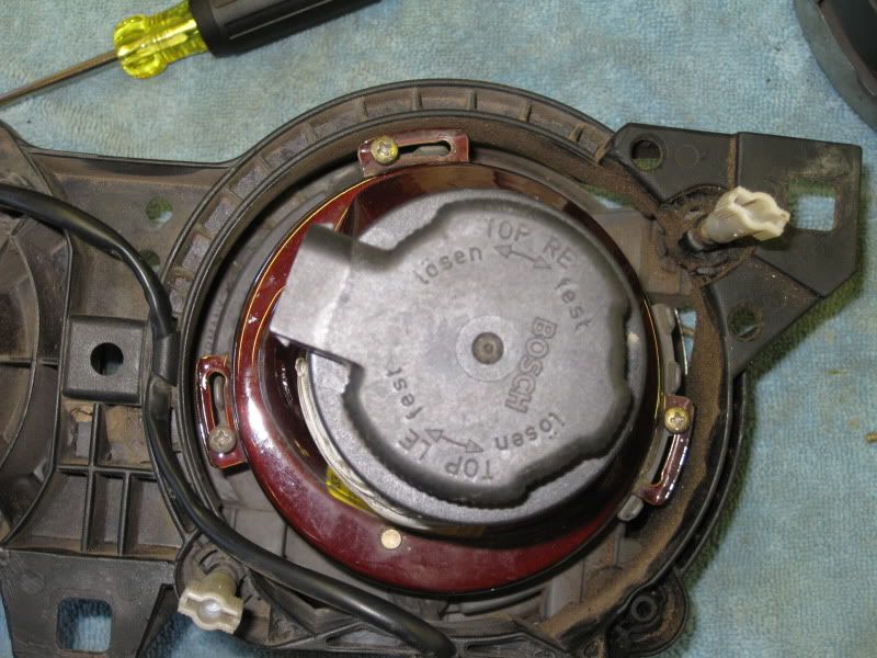

    I had this same problem. There are 3 screws on the back of the housing and little slots. you loosen the screws and rotate the housing. It should be self explanatory when you see it.

      you have to switch them to LHD

        Yup, they are from a right hand drive car.

          You just have to loosen and adjust them from the rear as stated. Enjoy the euros.

            One again I am amazed by german engineering. 10 minute fix. Thanks :up:
