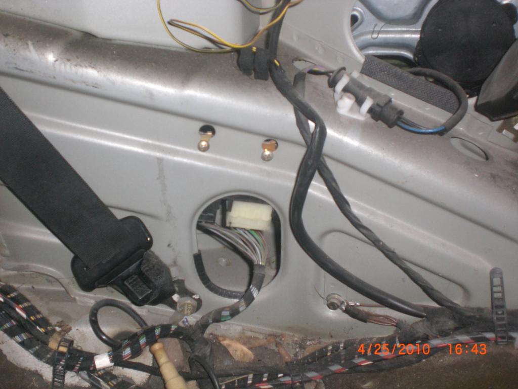

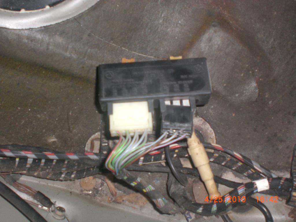

                      Finally tore it up and found the bastard it is behinde the driver side rear seat panel in the cabby mine was half way unplugged and it was the issue

                      and here is where the bastard hides

                          Thanks for posting that pic! I've been meaning to track down that little shit box for months now in my vert.
                          Luke's CRC cleaning badgering took care of my brake light and license plate light on the check panel. Gotta dig this little bastard up now.

                            Talk about delayed reaction...you get off the hook though, Daddy work is WAY more important!
                            So that seems to be the left side? Evil spot!
                            While you are in there, grab a 10mm, loosen that ground bolt, squirt some contact cleaner in there and retighten.
