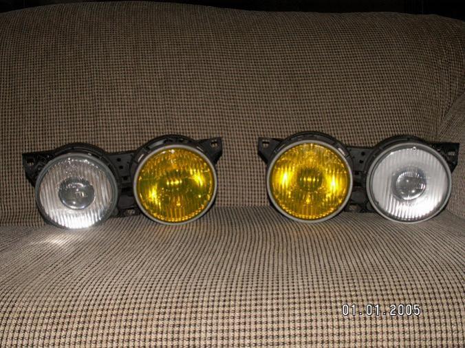

    Before I sold my parts car I pulled the projector lights out because I figured I'd want them in the future. I bought a DDM HID kit for it (already got the bulb installed into the back of the lights, and the harness is ready to go), but now my new 91 318is has the sealed beam lights. Apparently I suck at life and I'm having trouble finding a write up on how to do this...
    Any help is appreciated!
    I know a lot of people hate the yellow high beams, but I tinted these myself using some yellow tint I bought off ebay about 3 years ago, turned out decent I think... I might remove the tint and smoke them, haven't decided yet...

    I think you just have to rewire the sealed beam wires to a projector connector. I'm not sure
    Lights look good by the way

                              Good luck.
                              And put black cross-hairs inside your yellow to have smoked yellows!
                              Looks good.
