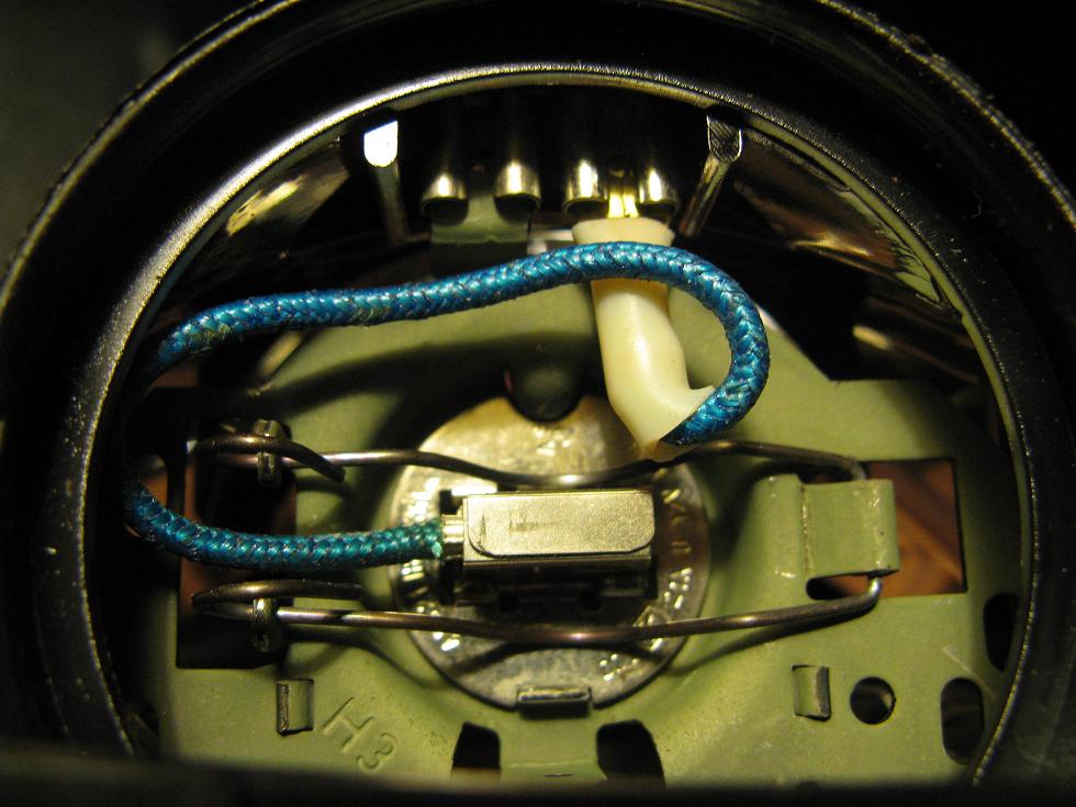

                Hope this picture makes things even more easier!

                  Wow.. okay, yeah that's basically the exact same thing then. You only have to plug the light into one of the connectors? What is the other one for?
                    The one is the ground that the base is in, and the otherone is the hot for the single wire on the H3 bulb.

                    • mamzak
                      • 883
                      Wow. Makes so much more sense now.
                      Thanks a bunch!!
