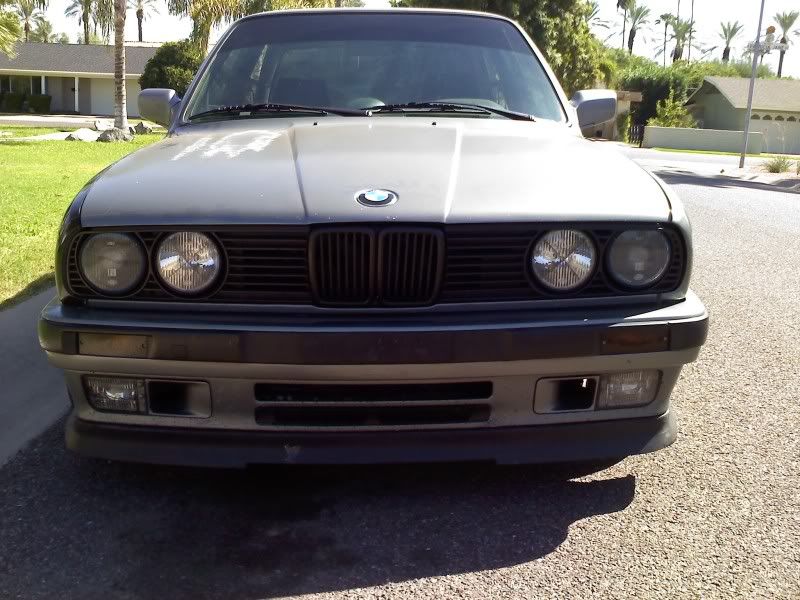

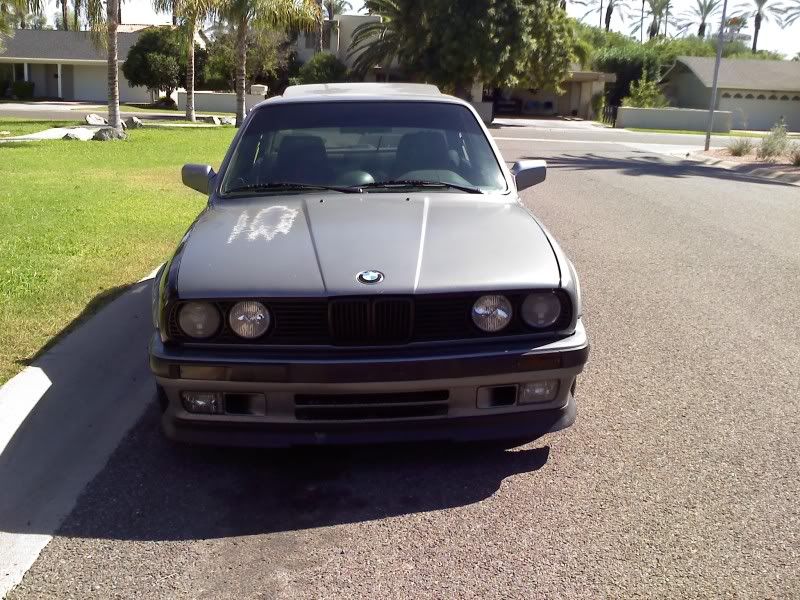

                  pics....see no stupid tint film
                  once the sun goes down, i will shoot some of the lights on
                        Why are your lenses foggy as shit? That might have something to do with it
                          OK, now I am pretty convinced you might be an idiot.

                            I know they're "smoked", but they look more foggy than anything. Maybe just pitted to shit but they don't even look black lol

                            • gearheadE30
                              • Jun 2007
                              • 3734
                              ^^ the fluting of the glass causes them to look a little gray where the outer reflector was painted, and the design of the internal optics and due to incoming light means that the projector part is never actually black. What you're probably seeing is ambient light being reflected back towards the lense. Pitting, however, can contribute to this.
