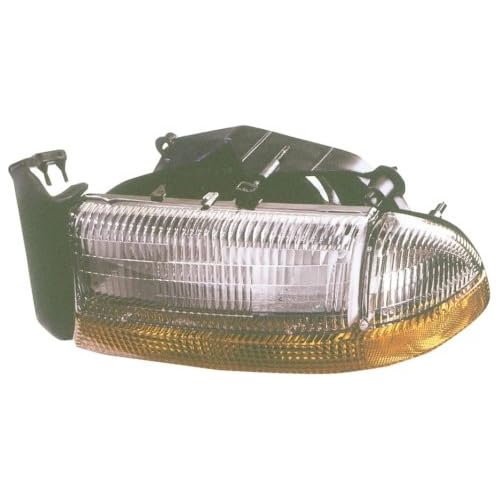

          No, I just want the high beam lens to be illuminated but not obstructing oncoming traffics view, the little city lights look lame IMO. What I'm looking for is turning the entire high beam lens into a low beam headlight but still being able to have high beams. Make sense?
          Take for example my old 2001 Dodge Durango. The headlamps were in the same housing as the high beams.
          See what I mean? Both high beam and low beam were both in there.

            Yeah I think you'd have to modify your grills to fit that.
            The durango uses a dual-filament bulb, so no, you won't be able to get that effect without a dual filament bulb, which will not fit.
