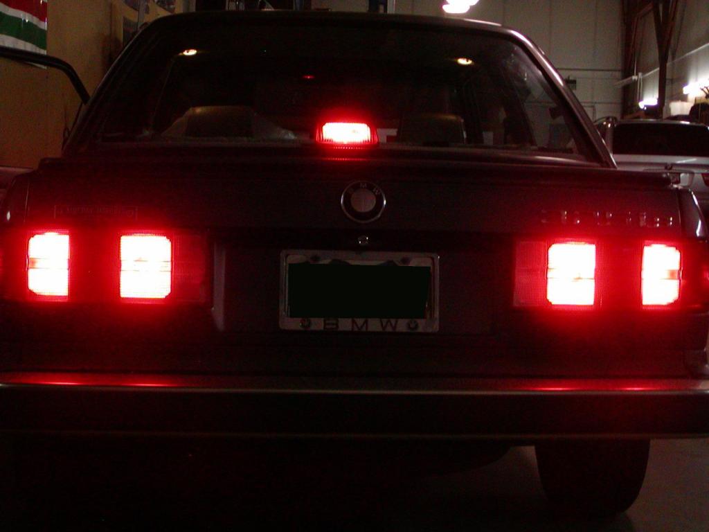

        I recommend upgrading to add a second tail light bulb and brake light bulb inside the stock lenses, way better for visibility and far safer than running with a dark side when a bulb fails! Contact me for details if interested. Twice as large, and more than twice as bright. They look perfectly stock otherwise, and will work as stock or modified, your choice, by simply swapping bulbs.

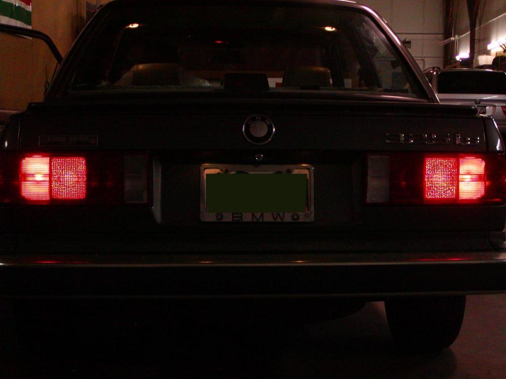

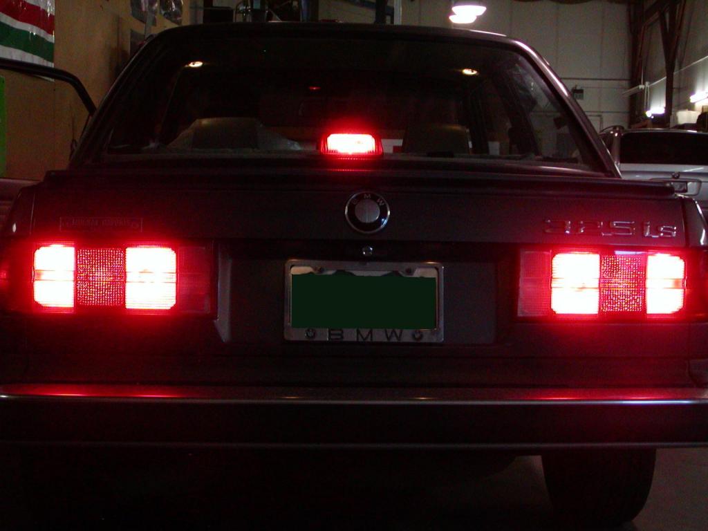

        In my experience, the old opaque bubbly lenses usually have a much more even output over a wide range of viewing angles, never the case with clear lenses. If they were tested by Consumer Reports, they would probably get high praise for sparkle, fast shipping, and low cost. Personally, I prefer a more effective light. See attached pics for my design, I can provide you with this upgrade any time you want.

          Updated the post with pictures of what I am talking about.
          If you are interested in buying a set of lenses, send me an email and I'll look if they are still available, we can do the deal at your convenience. I come across these fairly often, but it doesn't make sense to wait forever... What's your budget?
          Love to put those pics (above) in the body of the post so they can be seen side by side, I'll try that in a separate post.
