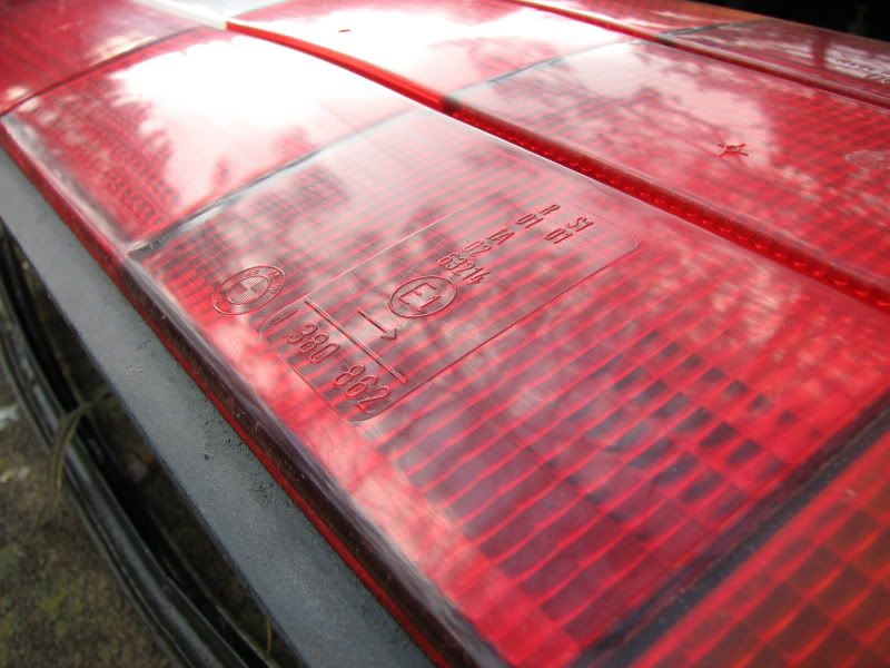

    The lights should fit as long as they are late models units. I swapped the
    tails on my car earlier this year for US units and all I had to do is to punch
    out the fog light blank. The fit was perfect. The only difference was that
    the euro set was tagged E-code and that the lights finish looked dull
    compared to the US set but I'm pretty sure they were not dull from factory.
    The set at the bottom is the Euro set
    E code
    Charley
