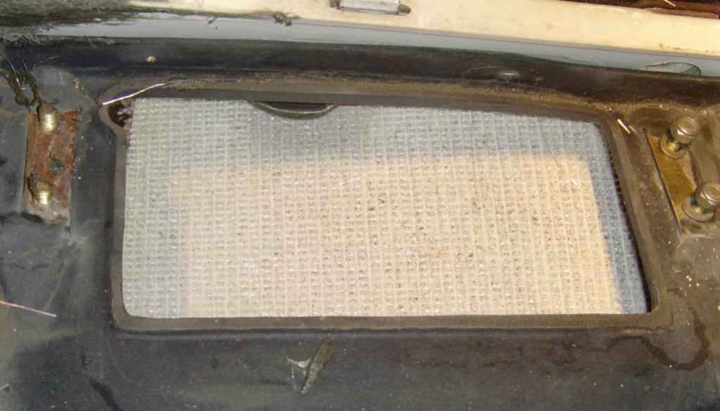

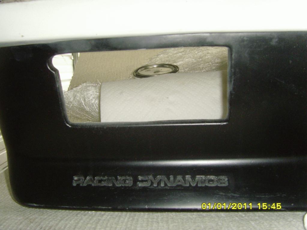

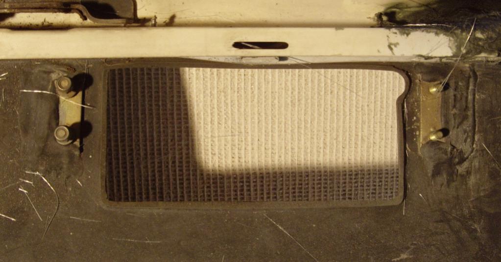

    I am fitting a Racing Dynamics front air dam on my car and the fog light mounts are a little odd. I'm converting to plastic bumpers in the process and want to have the fogs to go with everything else.
    There are 2 little studs on each end of the opening...(see pics)
    What lights am I looking for and where can I find them ?
    Thanks for any help !

    Looks the same as e30 m3 or mtech1 fogs to me. Whats the front cutout look like? And for early or late model car?
      My car is 86. But I am putting plastic bumpers on it. Air dam I got from a friend. It is Racing Dynamics brand. That's all i know...
      I'll try to throw a pic of the front side up.

        doesnt the oem early model airdam fog lights fit?

          It takes the M3/early euro fogs. You'll need the 86-87 Euro mounting brackets. I used the same on my Zender airdam.

            Thanks JasonC. Happen to have a part # ?
              01 is what you need (9/1985-9/1987), http://www.realoem.com/bmw/showparts...11&hg=63&fg=15
              The picture shows a 83-85 mounting bracket.
