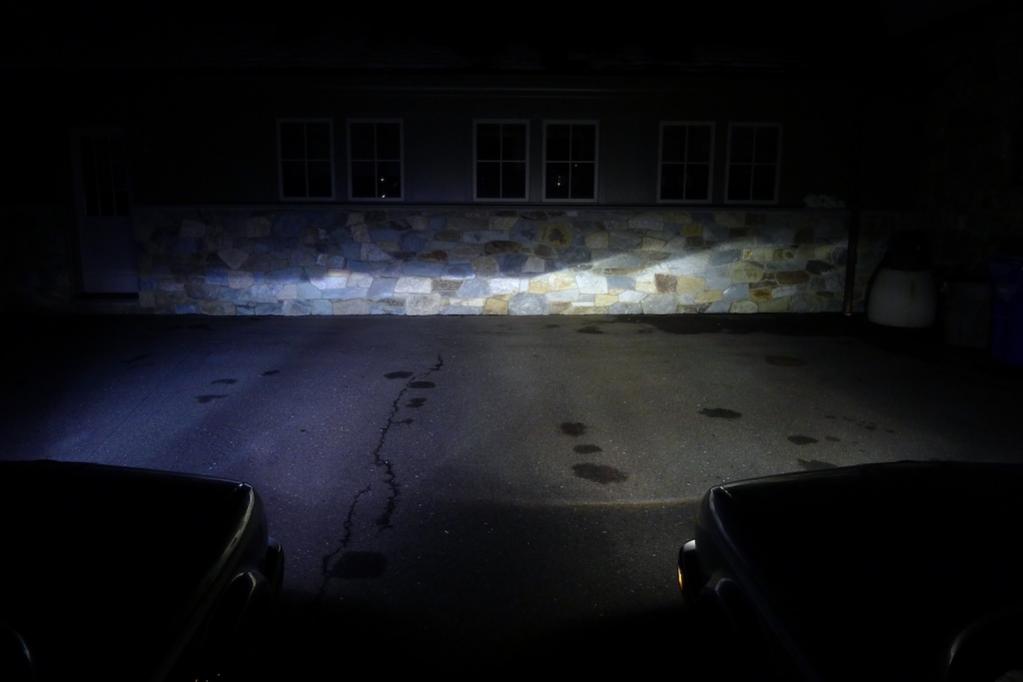

    OK, so now that I have something to benchmark against, I thought it would be interesting to do a little looking and to see if I could ballpark the actual color temperature of these bullshit bulbs that DDM claims are 4500K.

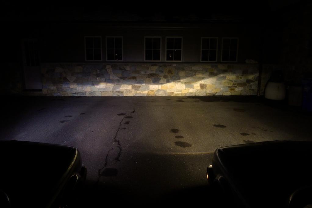

    The following are two version of the same picture. The ONLY alterations that I have made are 1) resizing, and two, setting the white balance so that one set appears roughly white.
    In the first, I set to 4500K. As we can see, the VVMEs are about where they should be. Maybe a little warmer than 4500K, but I'm not going to claim that running the white balance slider around is good enough for anything past ballparking. What we can also see here is that the DDMs are seriously blue. Absolutely nowhere even in the vicinity of 4500K.
    In case you're wondering, I picked 4500K as it is the claimed temperature of the DDM bulbs. I wanted to give them the best chance possible to appear, well, white. As we can see, they fail miserably.

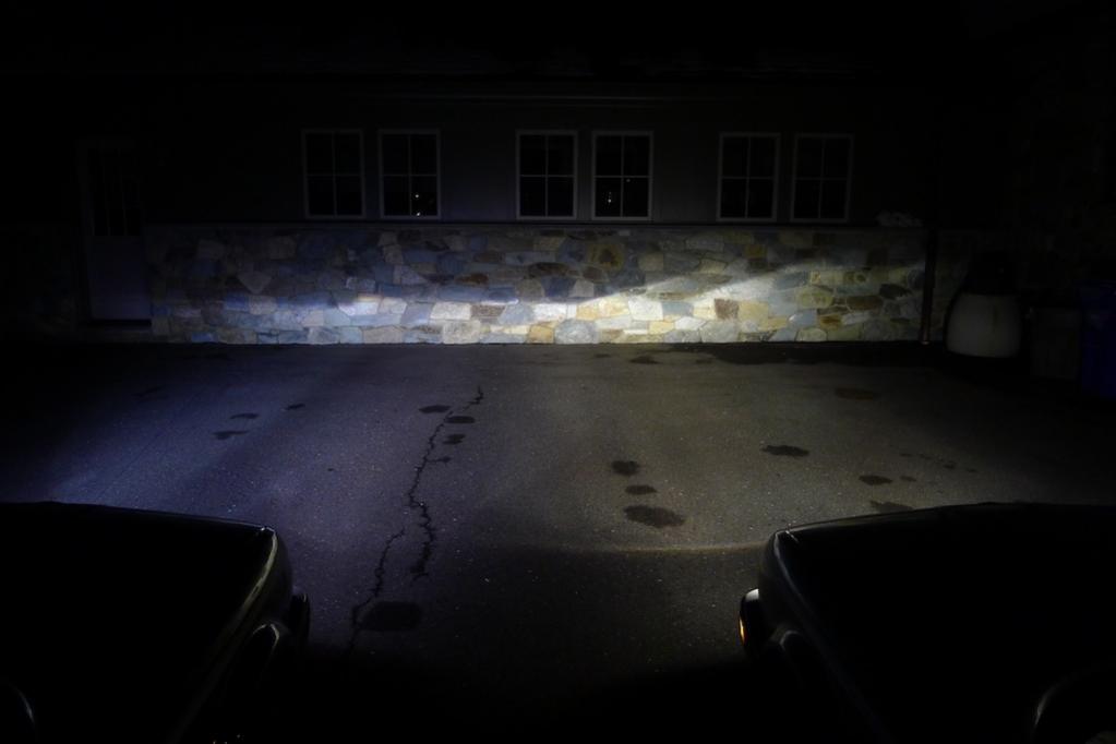

    OK, fine. So we know the DDMs are off. This leaves us with the question of "how far off are the DDMs?" In this picture, I set the white balance to 8000K. Even now, the DDMs are still showing some blue, but frankly I'm not going to go nuts here. Let's just say that the DDM "4500K" bulbs are actually at least 8000K. I wouldn't disagree with 10,000K plus or minus.
    So yeah. For the $50 shipped that you can get the VVME kit for (in 55W), I would have to recommend that over the $40 + shipping for a DDM 55W kit. FWIW, I bought on eBay from "obdmart" which appears to be VVME directly. I then bought a couple sets of bulbs to replace all the DDM ones that I'm currently using directly. They are cheaper if you e-mail for a quote.

    I disagree with your methods entirely. I have a 2 or 3 year old 4500 55w kit from ddm and its white. Their newer stuff, maybe tits up (blue-er), but your methods are piss poor for comparison.

      I have four sets of DDM bulbs. D2S, H1, 9006 (x2). They range from 6 months to three years old. The H1s and the 9006es are roughly the same color. The D2S bulbs are bluer.
      Since you disagree with my methodology, why don't you suggest one? Remember that the color temperature of the bulbs is the same as the white point when you set color balance. Would you prefer to see an untampered picture? I can give you that too. This is pretty close to how they look to me in reality:
      Any way you slice it, I have not yet seen a DDM bulb that looks anything like the 4500K that I've ordered from them. While I won't claim that a sample size of four is conclusive, I do believe that it is significant.

              not sure how your camera shots actually compare to what the human eye sees, but my 55w 4500k ddm lights are WHITE. i hate blue headlights, and they are not blue, i would have changed them long ago.

                My 35W DDM 5000K cheapies have a damn near purple haze around them.
                EDIT: Mine look like that first shot.

                        The camera shots are pretty close to dead on. The DDMs are fucking blue.
