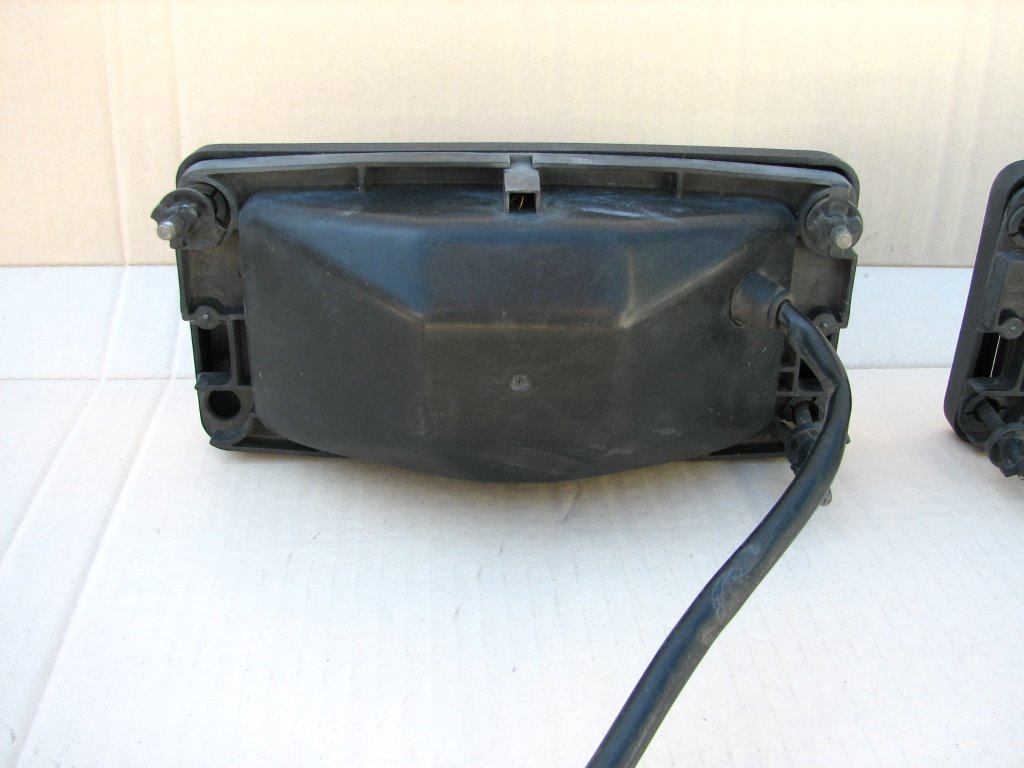

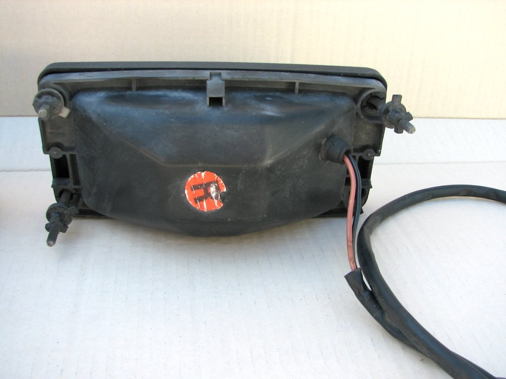

    1986 325es fog lights
    Are the light brackets the same for both sides? Anybody have pics of the two backs side by side if they are not the same? Thanks.
  • td325ic
    • Feb 2006
    • 788
    The black plastic fog light buckets are the same but the location of the adjust screws is specific for each side. So you just have to take a flat headed screwdriver and pop out the adjusters and place them in the correct holes.
