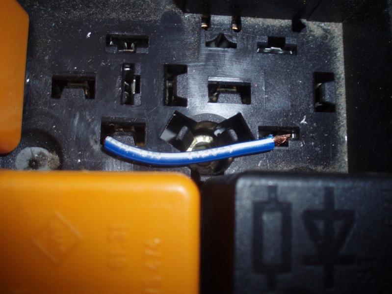

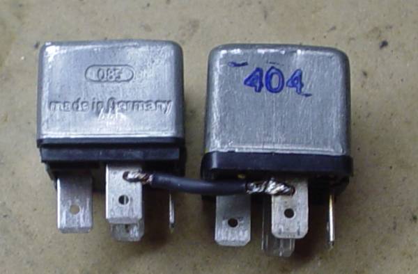

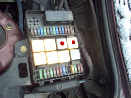

        Like this...
        Or you can solder a jumper to the relays themselves.
