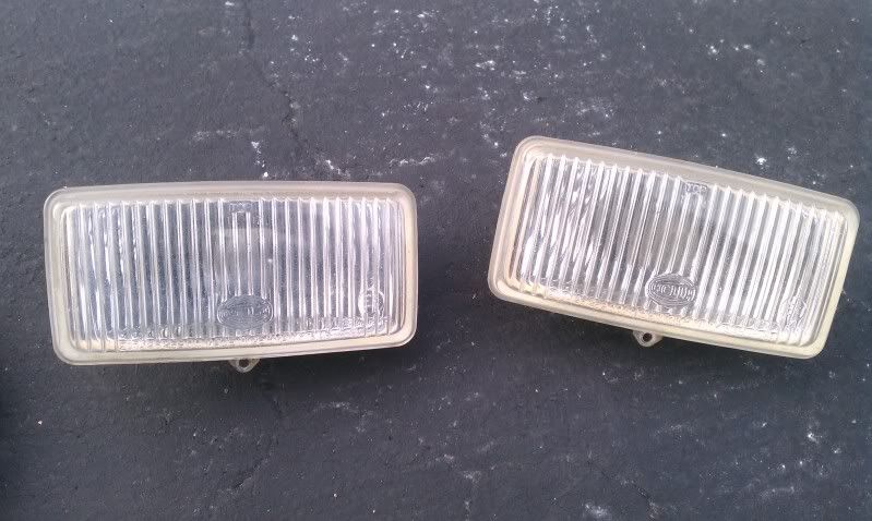

                I have a set of these with great lenses if anyone is interested.

                    Lol, I have just had them for a while. I had them for sale at one point but got no bites or even offers so I took them down.
                      Taylor
                      Sure those are for the euros? Cause euros dont have that tab at the bottom.

                        Having just replaced a fog light on my euro, they don't have that tab on the bottom, and they are a little less 'rounded' overall
                        Will dig the old one out (with broken glass) and take a pic when I find it
