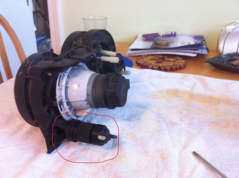

      One more question. What are these black units on the lower adjusters of the low beams? The little screws at the ends are rusted to shit I'm not sure if they are working or how they even work. I don't see them on the microfiche for the north american elllipsoids.
      I circled it.

        euro headlights adjusters so that you can adjust the headlights while sitting in the car. vacuum assisted i believe?

          Yeah that sounds about right. I think I'm going to have to cut off the bracket and ditch them because I cant get them to adjust. Looks like a regular mechanical adjuster will fit in place of it.

            Update:
            I ended up cutting off the vacuum assist units (they were shot anyway) and installing all new adjusters adjuster in their place. Its nice to be able to see at night again.
