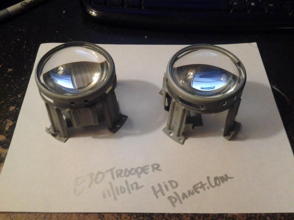

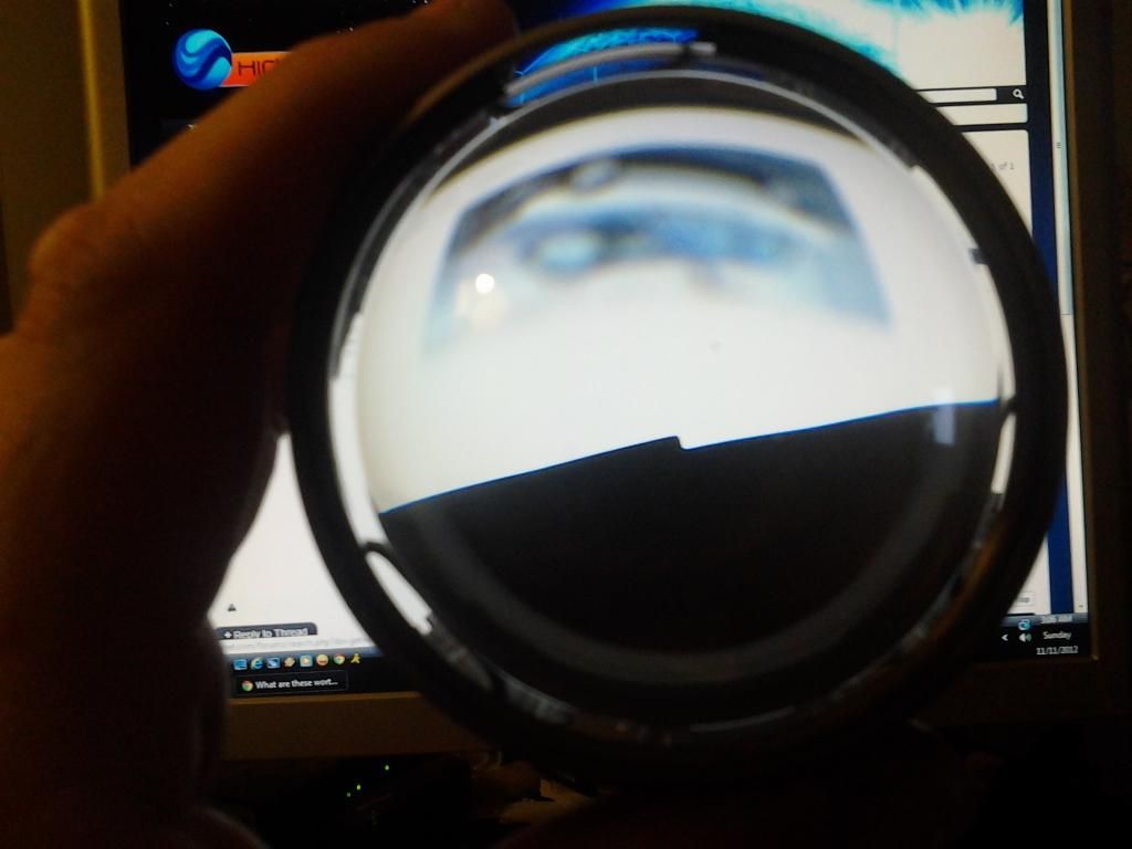

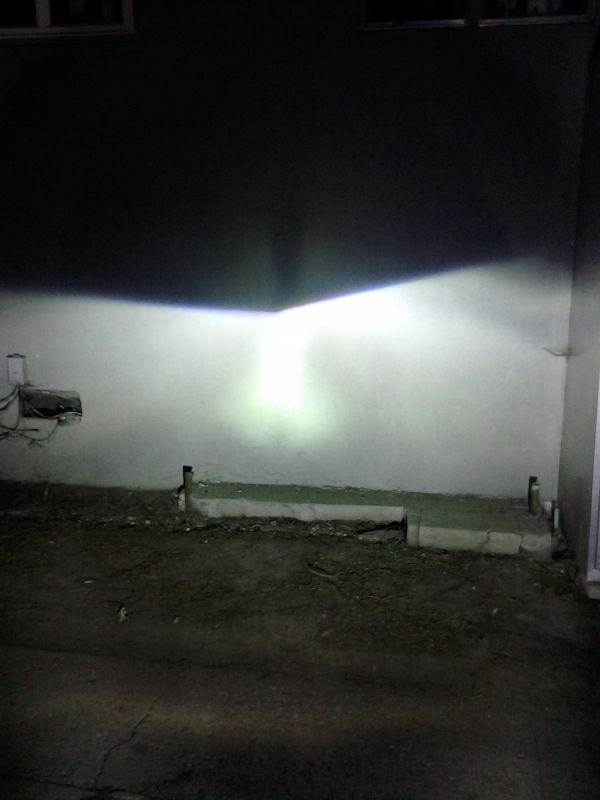

            Not true. The Euro's dont have clear lens. The US ellips however have clear lenes for a sharper cut off. Id personally recommend US's for a pnp hid kit. Its a better projector.
            Bosch euros
            US Ellips
            If you really wanted to do good. You could mod the cutoff in the us. Also Ive heard you can install the US hella shield/lens combo into the hella euros. So then you have best of both.
