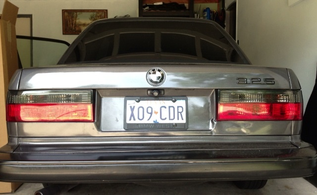

        heres some all red/smoked ones i did myself. the only thing i dont like about the MHW is they kept the amber corners.

              Good write up, thanks for the link. Gonna use testors like dub did on his.

                i tried. not as dark though

                  I did a second go. Little bit darker

                            You rarely see the ebay one on here, due to the rice factor. But OP, looks like you did a good job on your stock units.
