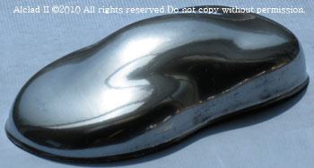

          A few options:
          ALC-105 Polished Aluminum ALC-107 Chrome for Plastic ALC-114 Chrome for Lexan* ALC-115 Stainless Steel ALC-118 Gold Titanium ALC-119 Airframe Aluminum ALC-124 Black Chrome ALC-126 Hi-Shine Plus®©™ Choose any of the links below to find out more information on other Alclad II finishes  Regular  High Shine  Transparent  Prismatic/Holomatic  Hot Metal  Aqual/Klear  Primers/Misc Candy       CONTACT US Your Message Δ ... Read More
