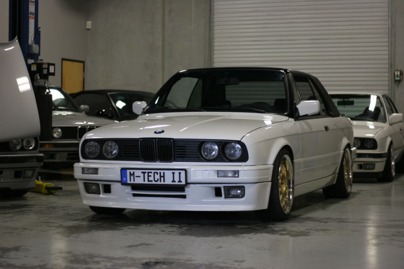

      standard 325i late model ones. that mount like any other late model car. then the mtech2 valence covers over the top

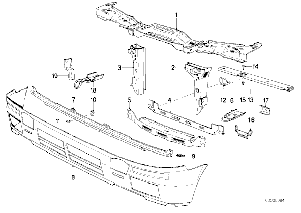

        so the m tech 2 valance mounts over the top of the other valance that has the fog light mounts. as it stands the only thing i have is this. it has a single mounting point at the bottom but no place for the four screws.

          We're talking about the stock metal valence...

            the fog lights are mounted 100% as stock on a 325i. you mount them to the late model valence. then you attach the mtech2 valence over the front of it.
            pics from my old car. they paint the valence black around the lights from factory.
            fixed

              404 - File or directory not found.
              This is the stock valence...#8
