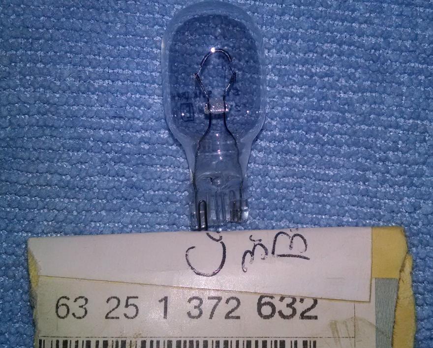

    It's actually 4 screws that hold the 3rd brake light on. 2 hidden under the foam pad for the tool kit, and 2 at the top of the trunk lid, sort of under the tool kit itself. Part number and light bulb pic attached, or Sylvania/Osram 921k

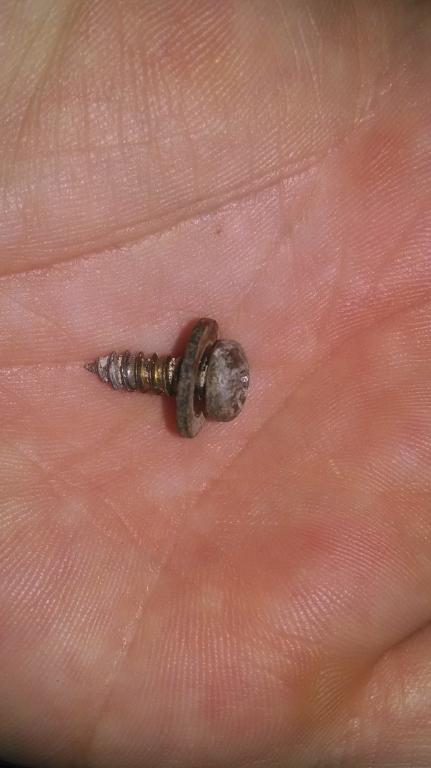

      You have an early vert, Sean? I had 7 screws - 4 in the vicinity of the toolkit, 3 at the front of the trunk lid.
      I couldn't find the part number for the screws but just got some matching size screws, washers and rubber washers at the depot. Rubber washers are critical to prevent leaks, mine were dried out and leaky.
