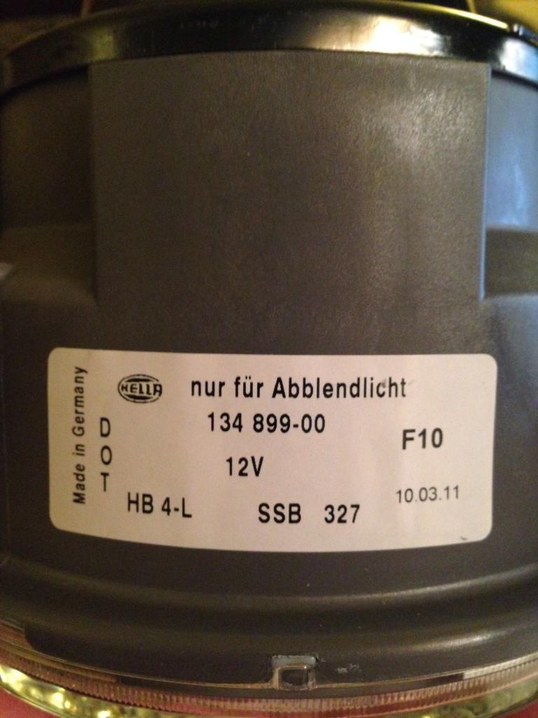

    Just bought these off ebay. Not sure what bulb it uses? I bought them to use the back reflector part but doesnt look like it will workout. Then I tried looking up the part number but doesnt show up on realoem? Help on identifying what this model headlight belongs to?

    That's a Left side e30 US ellipsoid low beam. Bulb = 9006
    The three screws that hold on the back reflector come out with a #3 Tri-wing bit

      The bulb is noted on the label, HB 4-L, more commonly just 'HB4'. It is also called 9006.
