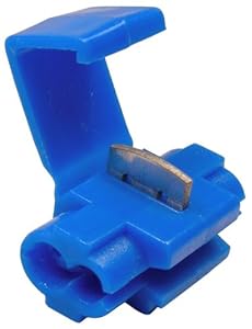

    You want to use tap-ins to get power from the front side markers. If you use tap-ins, you won't have to cut any wires on the car's wire harness. You'll need 4 of them. I used blue ones, but the bigger red ones will work too. Your city lights will come on when you pull the headlight knob out to position 1 (for parking lights). The city lights will stay on whether the low beams or high beams are on.
    On each side of the car:
    1) Remove the headlights assembly
    2) Pop the side marker lens out so it is hanging loose
    3) Pull/push the side marker wires in/out, so you can see which wires go to the side markers from inside the fender (right behind the where the headlight assembly was mounted)
    4) Make a 2" cut in the plastic casing that covers the + & - wires for the side markers
    5) Use the tap-ins to attach the city light wires to the side marker lights. Brown to Brown and the non-Brown to the Non-Brown.
    Done.
