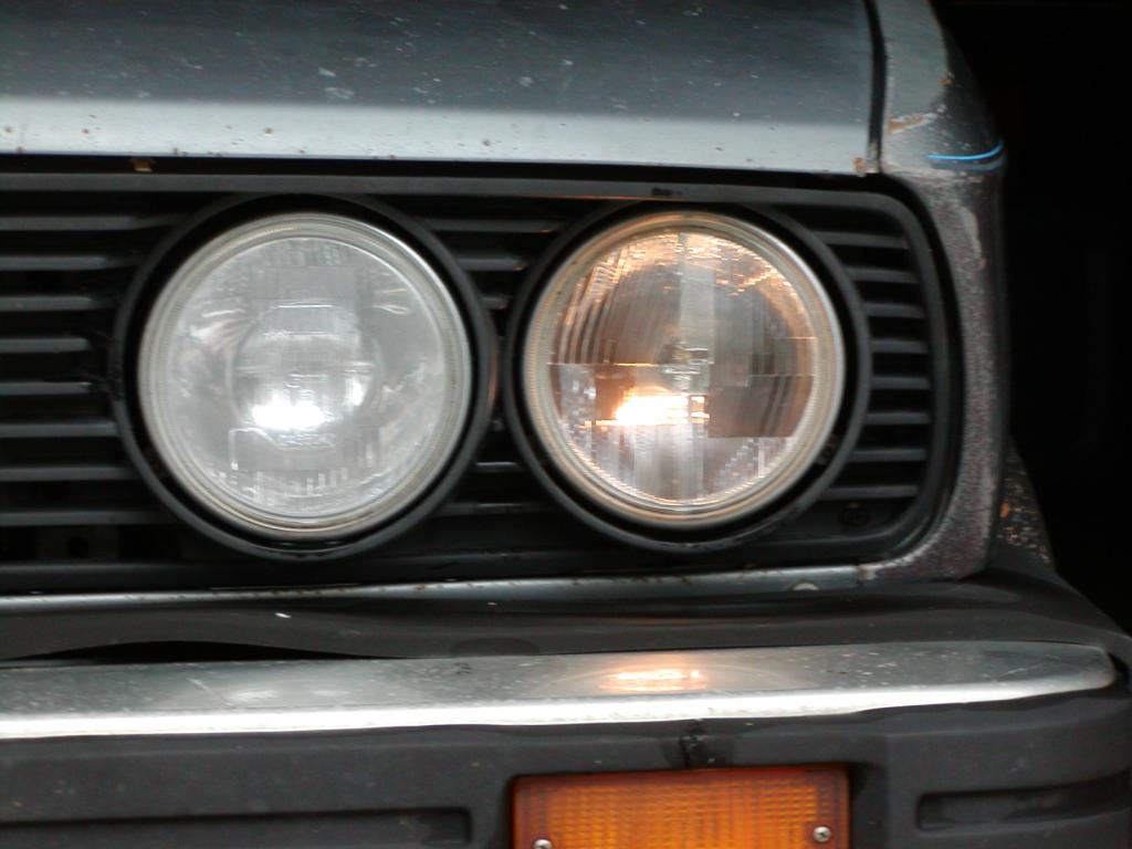

            any pics of the setup with citilights?
            thanks
            • Mo Brighta
              • 431

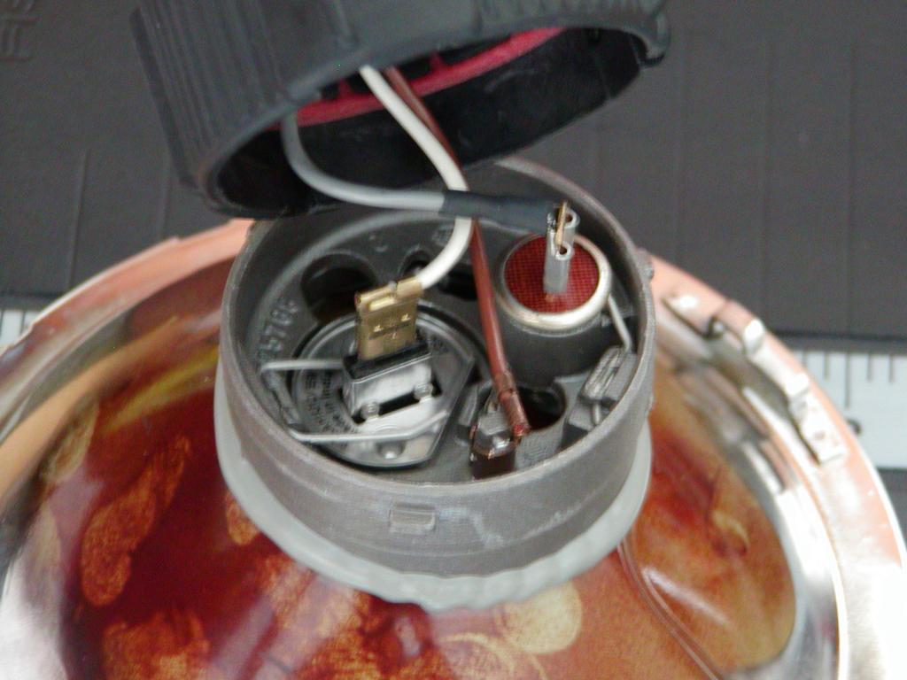

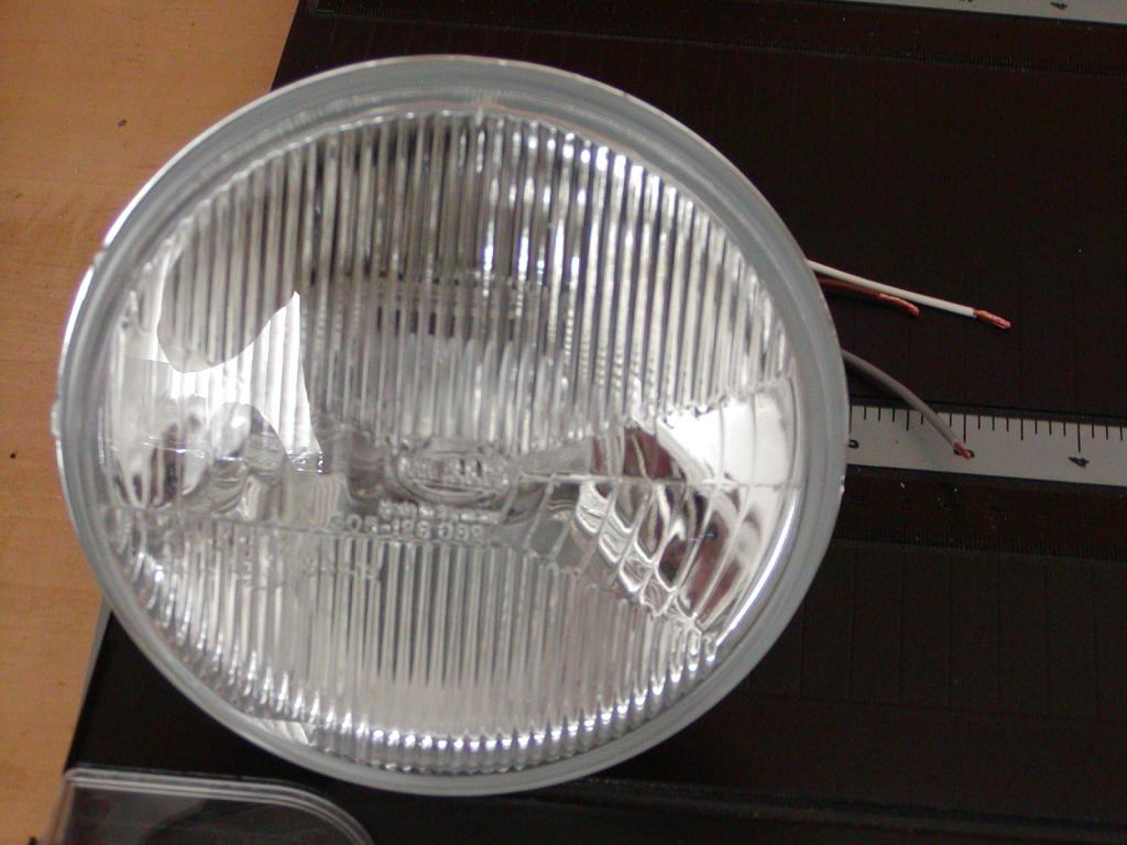

              BiFocus pics
              OK, here are some pics of the lights as received, I'll try to get some pics of a local installation with the city lights working. I installed a pair for a guy last year, he said he would hook them up but ... I'll ask. Maybe he'll see this and post the pics himself???
              Anyway, the light includes a cap with two wires, brown and white for ground and power. They take an H1 lamp.
              Face of the light

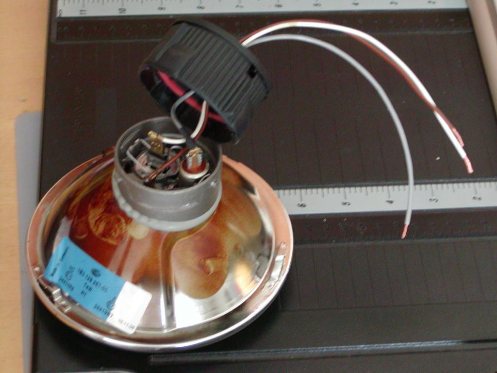

              Back side with cap and 3 wires
              Closeup of wiring, city light option (grey wire)

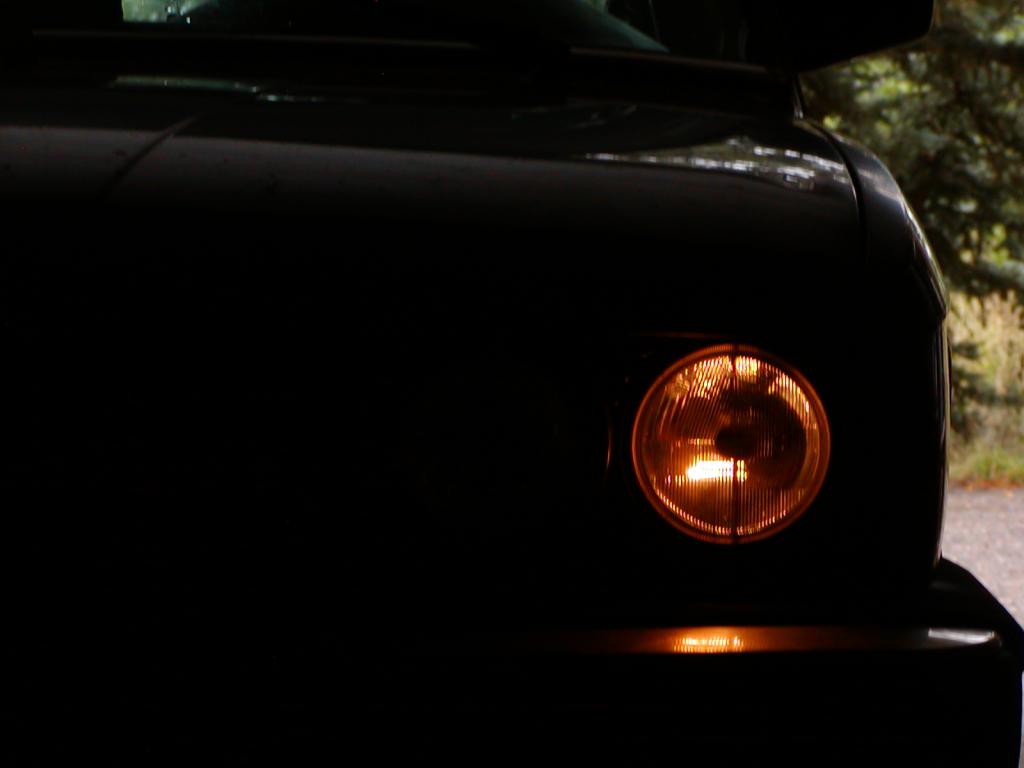

              Anyway, FWIW I'll include a pic of my car later with similar lights, showing city lights turned on. I do get the occasional 'Hey, your headlights are out' when I run them, most folks do not know what they are and think my headlights are dim because the bulbs failed or were installed wrong.

                  The bulb is a mini-bayonet (b9s), typical bulb #1893 (standard output).
                  There are colored, high output, long life, and many other variations. My best bulb is high output (naturally) - 3886X (Xenon gas filled).
                  Bulb data: 1893 is 4W 3cp, 3886X is 6W 7cp (233% output), $7.50 ea.
                  I think I can get High Beams with a similar feature, I'll look into it.
                  Here are two pics of the city light on, one in day light, one in the garage.
