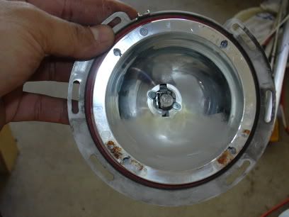

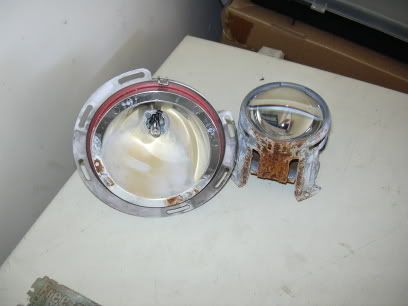

        Can anyone chime in on the problem? I have the same situation right now with my passenger euro non-smiley. It's dim and doesn't have the colourful cutoff like the driver's side does.
        • duckyrocket
          • Apr 2006
          • 31
          Well, I did some investigating and found this...
          So if anyone is having any problems with the light output, take everything apart and have a look. Anyone have any ideas on how to remedy this? I might try some CLR on the projector bracket/cutoff, but I don't know what to do about the reflector.

              Hey Yan, thanks a bunch, but don't worry about it. i got the set of lights from mikeedler, and when he saw the pictures he sent new ones out right away. problem fixed!!
