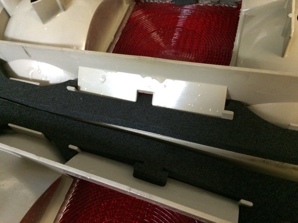

                      Fitment is all the same but there are small differences, the one I ran into, other than the colors not matching, was that the gasket had cutouts on one but not the other tail light. I haven't looked at mfg dates to know, but these are on my 85.
