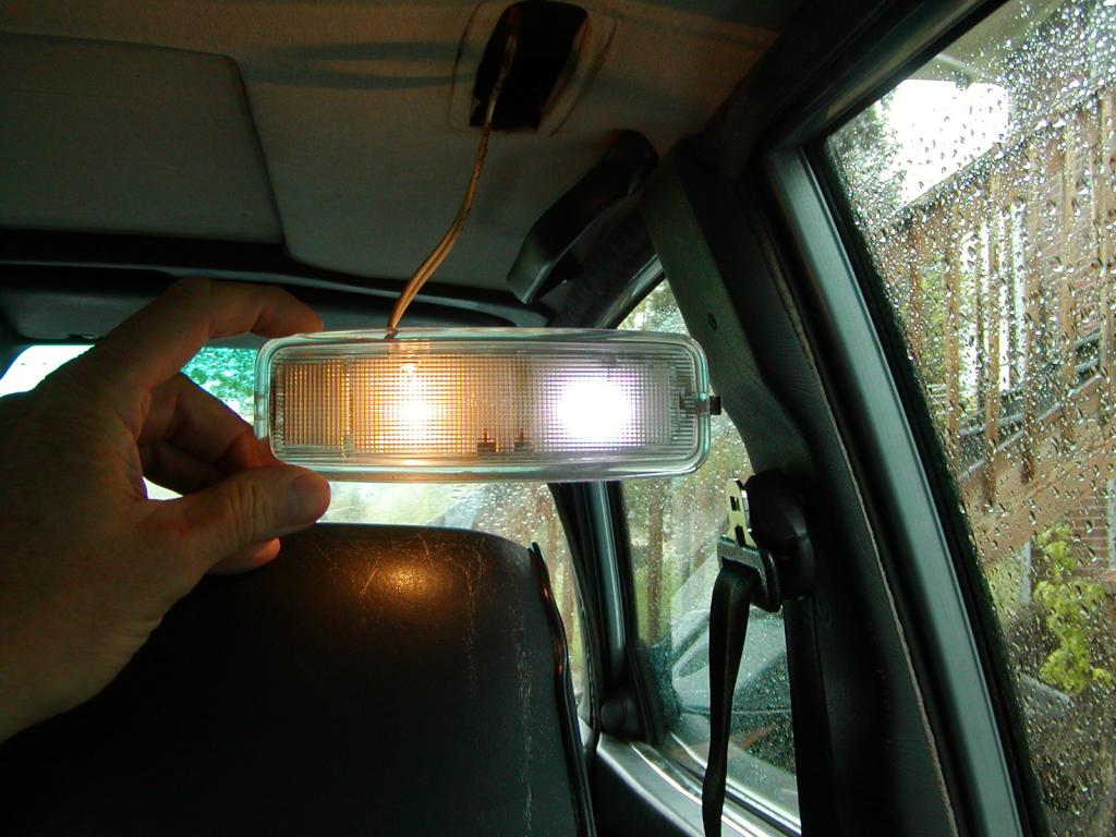

      I just bought half a dozen for an E28, they are 11 x 44 mm. Festoon or torpedo style. Kinda nice, a bit brighter than the 10 Watts in my dome light. They key is length of the lamp overall.
      Here is a pic of led and regular old style side by side.
      LED is on the right, regular tungsten filament on the left.

      Is this what you had in mind?
      If you'd like, I'll check with my guy to see if they are available in your size, just need to know the length of your lamps 'point to point'.

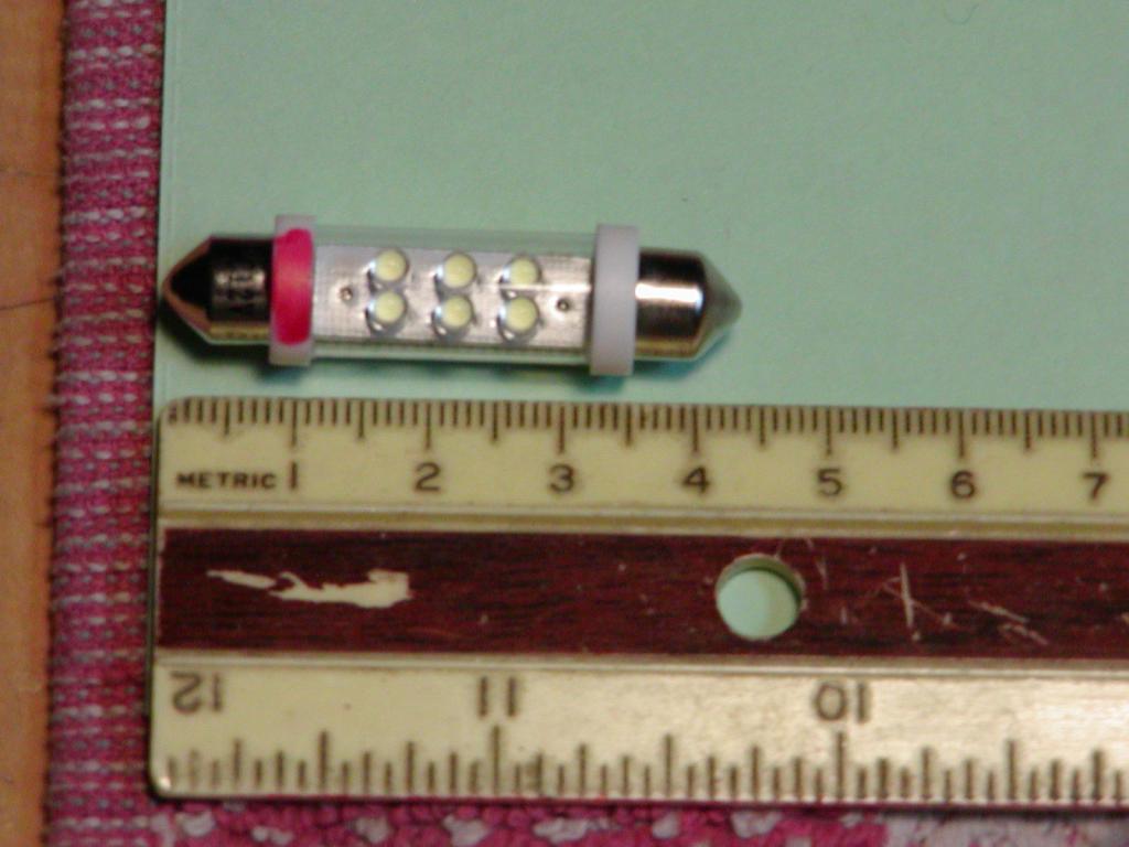

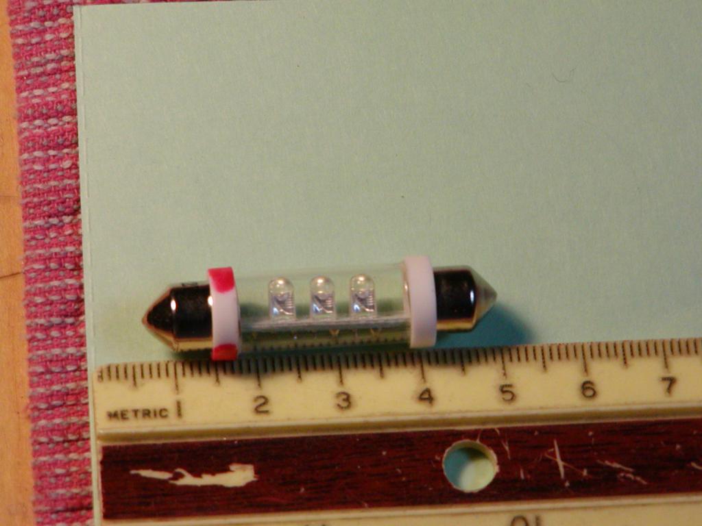

                They are 'Festoon' or torpedo style, pointy contact on each end.
                The stock tungsten version has a long straight filament going end to end.
                This LED version has a tiny PC board with six LEDs all facing one direction. It is 44 mm long, fits your Dome light perfectly. Replaces US bulb no. 6411, 0.48W. Eiko brand, retail $9.71, my price $7.50.
                The trunk and license plate take a 37 mm long bulb, replaces bulb no. 6418. Still searching for this one, price likely similar.
                Both are 12VDC. The stock is non-polarized, + on either end. The LED is + one end, - other end. I mark them with red on the + end after testing, then installing them in the car and evaluating if they are useful.
