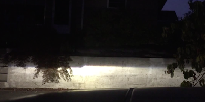

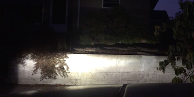

The Morimoto Mini H1 is a bi-xenon projector, meaning enabling the high-beams actually changes the lighting pattern of the Mini H1 projector. This is done through an electrically activated shield that cuts off the light in a sharp line when in low beam mode, but flips out of the way when the high beams are enabled.
Here is the Mini H1 in low beam mode on the left, and high beam mode in the middle, and together with the actual high beams on the right:
And all-together:
