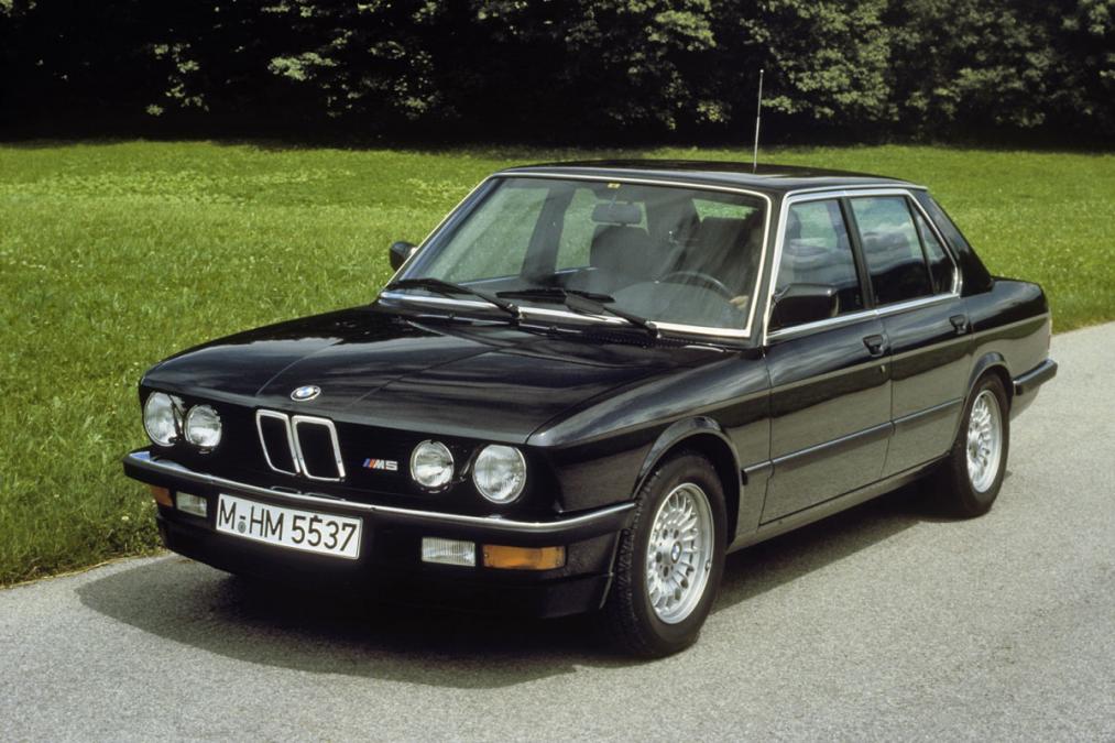

    I suppose I'd vote you enlarge the outer/low beams aesthetically speaking, although I prefer the equal size lights on this car. The E28 pulls off smaller low beams well, but you're going larger instead. You also have to consider the beam pattern/adjustment of those lights being used as low beams. Are they fog lights or driving lights?
    • LateFan
      • May 2013
      • 4430
      As he says, the E28 euro nose had bigger outer (low beams), which looks cool. The Lancia look is a little too funky I think.
      The E28 was 7" diameter outers and 5 3/4" inner (highs). It would take some real surgery, and epoxy doesn't do well on most plastics.

          that doesn't look like a low beam pattern. i would assume any hella light with a clear lens is going to be a "high beam" driving light.
          you will be left with no low beams if you swap the outers.

            Interesting project idea, but I'd just like to say that those clear lenses aren't going to make for a good low beam. The point of all the lines on the sealed beams (or Hella or Cibi H4 conversions, or what have you) is for directional light output. If you run those, not only will you have lots of wasted light downroad, you'll fiercely blind oncoming traffic.
            I know this is kinda a form-over-function kind of thing, but I don't think it's worth your time. And if you're driving at night, I'd assume you'd get pulled over constantly for endangering others... Even though you don't mean to.

                While high beams DO typically have higher wattage bulbs than low-beams, it's the lens that makes all the difference in where the light (even if it's low beam light) goes. Think using a low beam bulb as "Blinding oncoming traffic", V. a high beam bulb "burning the retinas of any poor soul in front of your car".
                If you've ever been blinded by someone with poorly aimed lows, you know what I mean.
                I'm not sure if you'll be able to get new lenses for your lights, but if you're serious about this project, you want to find something thats designed to work as a low beam. Say, the oversized low beam off of an e28.

                    My guess is that's an auxiliary driving light meant for a bumper mount. If it's 6.3", that doesn't jive with a standard headlamp holder or backing frame.
                    There's no fluting in the glass to aim the light as these guys have said - it's just the reflector shooting it out there. The light pattern looks like a blast of light - there's no real shape, there's no cut off.

                      Those hellas are flood lights which aren't right for low beams at all. They can be used as high beams. Take a trip over to the danielsternlighting website and read up on different kinds of automotive lights
                      You can get bulbs called "hella H4 conversion e-code" which are 100x better than sealed beams and plug right in
