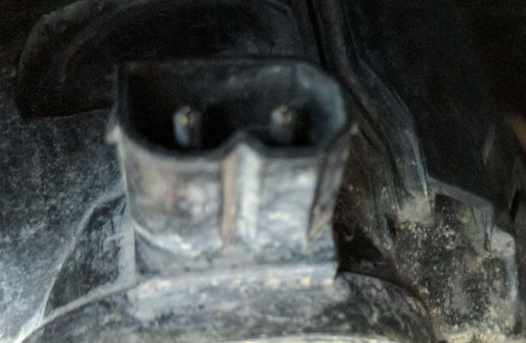

    Can someone tell me what pigtail I need to connect these or where I can figure out what connects to them? My car came with the foglights disconnected but there appear to be lenses, buckets, and bulbs and a harness. I'm hoping I just need to wire them up.

    the pigtail should be dangling there somewhere above the fixture or maybe its tucked in somewhere in the bumper... get under there and take a look... it could also be pulled up stashed near the a/c unit on the pass side or under the air vent by the front light on the driver side.

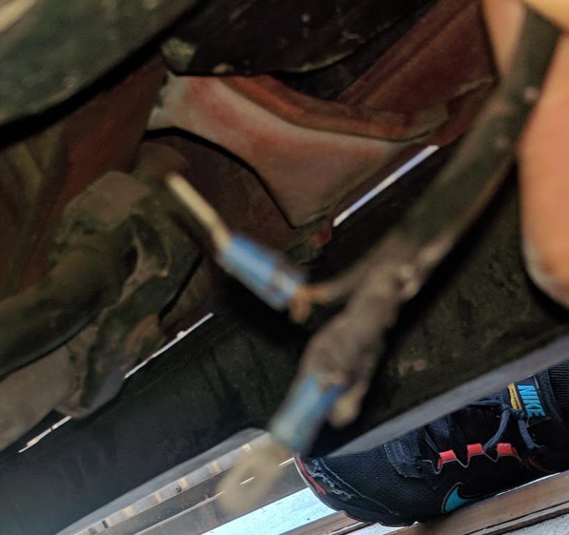

      Someone, assuming one of the PO's disconnected the portion that goes to the fogs. :/

        Hack job, nice!
        Plug housing part number is 61131378418. Wiring pigtail that fits inside it is 61130007446. You need one housing and two pigtails for each light.
        https://www.ecstuning.com/b-genuine-...g/61131378418/
        https://www.ecstuning.com/b-genuine-...h/61130007446/
        Alternatively, you could cut some off a car from the junkyard. Several different models used these plugs. Just make sure you get the correct shape. The number of angled corners changes depending on the application.
