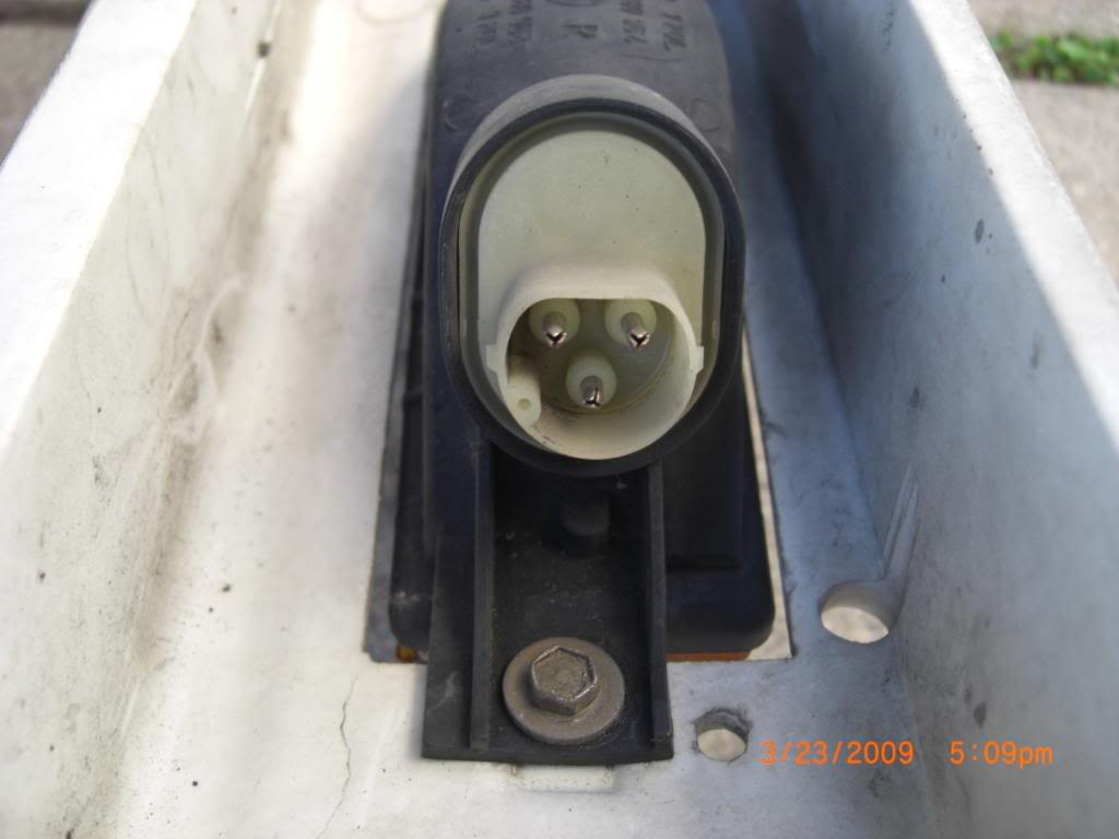

    Front turn indicator socket
    Thought of making a whole new thread about the socket, i asked about on the old thread...
    So, is the white socket in the pic removable from the indicator housing?
    And does anyone know the part number for the socket?
    :hitler: IT HAS TO BE ONE WITH THREE PINS :hitler:
    Would love to get the US-park working, without drilling extra holes to the housing nor cutting wires.
    Realoem doesnt show the part anywhere and cant info about it anywhere.

    As far as I know, the socket is not available separately. New light housing are pretty cheap though. #1 here:
    https://www.realoem.com/bmw/enUS/sho...diagId=63_0150

      Yeah, just got info from Schmiedmann (BMW Specialist here in europe), that they aren't available separately.
      RIGHT TURN INDICATOR
      63-13-1-380-966
      LEFT TURN INDICATOR
      63-13-1-380-965
      There are the part numbers for the USA indicator, with the 3-pin socket. In case anyone else starts looking for the same info:giggle:
