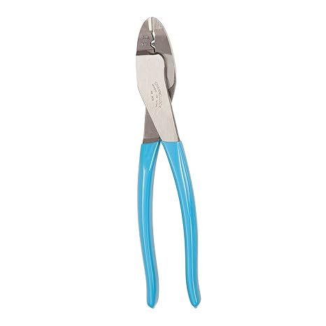

Buy a good set of crimpers though. Channellock makes a nice set (~$20) as does Klein and a few others. Don't bother with the stamped metal ones you can get for cheap. They are garbage.
