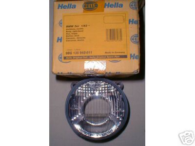

                im surprised JJe30 hasnt chimed in yet. he bought a set of hella smoked lenses thinking they were the whole light set (brackets, housings etc). they came from germany but were advertised poorly on ebay. the seller has them on there quite a bit, its been awhile since ive looked for them though.
                  here's what i could dig up.
                  I took the p/n from the pic that T.Dot_E30 posted and found this
                  9BG 135 941-011 : Dipped Beam Lens - LH
                  9BG 135 942-011 : Dipped Beam Lens - RH
                  I'd love to get my hands on these.

                      Originally posted by T.Dot_E30 View Post
                      they do exist.
                      but I've only seend one person selling them, donno where he got it from.
                      FWIW that is not just the lens but also the lens housing. They are still available though nobody can import them into the US as they are non approved lighting.
                      I went through a dealership in Canada. They shipped them to me. There is a company "AL" that is now manufacturing them. So Hella and Bosch ones are limited. And again, this is for the whole lens housing, not just the glass. (So you would have to dismantle and smoke them)

                          throught the stealership they are all still available, the hella "smileys"/ hella "nonsmilies"/ bosch"smilies"/ and bosch non-smilies" as well as the "french" yellow tinted glass lights like the ones that I ordered for mine. you just need to order non ECE parts from the ETK.
                          but like mentioned here, it is not just the glass, it is the housing also without the ellip. part.
                            mikeedler - do you have pn#s and prices on the non ECE parts ? I am curious how much they are new, also the yellow highs..
                              my etk on my computer isnt working anymore, but when i bought mine, they were about 80-90 euros for each outer lens, and about 65 for the inner hi-beam. dont forget, you need a set of euro ellips first for all the other parts.
