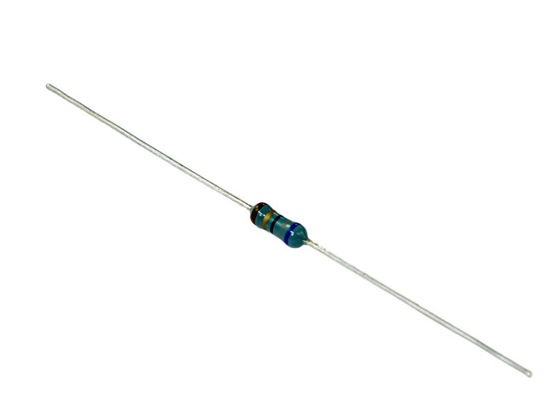

              I did that too but found that the 3rd light comes on dimly without the pedal being pressed. It comes on fully bright with the pedal. Not a problem IMO, just wasn't expecting it.
                When using an LED bulb for the third brake light, soldering the two green/black wires together got rid of the check panel warning light for brake lights. The LED bulb was dimly lit whenever the ignition power was turned on. Twisting on a tiny 6 OHM 0.25W resistor onto the socket terminals solved that issue.Click image for larger version
