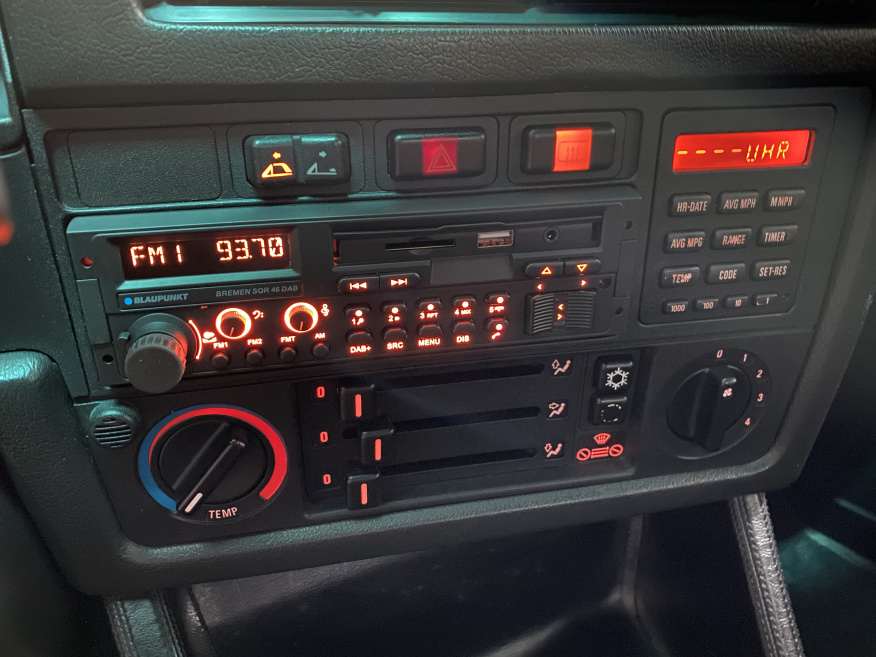

    New radio, amp & speakers
    For my M Technic…
    Blaupunkt Bremen SQR 46 DAB
    Blaupunkt AMP 1604 4 channel amp
    JL Audio C2-525x 5.25” coaxial speakers (4)
    Sounds AMAZING!

            Any chance you have that in a convertible? Can you read the screen with the top down and sun? Thanks!
            1992 318i cabrio Alpinweiss 2
            2006 ZHP cabrio Imola​
              Yes, it’s a convertible (all M Technics are). This particular unit has a lot of adjustability on the brightness of the display (as well as the color and a few other display-related features), so yes, it’s easy to see with the top down…

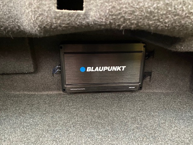

                      So you replaced the component speakers in the front kick panels with all new coaxial speakers ? Did you unplug the factory OEM crossover door tweeters? Seeing how the JL units you installed have their own built in tweeters ?
                      I assume you Then removed and bypassed the factory amp and installed a blaupunkt inline basically assuming the place of the factory amp?
                      Did you use rca input from the new head unit or did you use speaker HI -inputs directly into the aftermarket amp then run each Individual speaker from the amp output using the factory wiring ?
                      ‘’I’m curious I might do this as well …
                      • Uber///m3
                        • May 2018
                        • 294
                        Yes, we replace the component speakers in the front kick panels and in the back side panels with all new coaxial speakers. No, we didn't unplug the factory OEM crossover door tweeters (LOVE them highs right in front of you face on certain tunes). Yes, we bypassed the factory amp and installed the blaupunkt amp inline and mounted it in the trunk against the back (you can't see it while standing looking at the trunk) and used the RCA inputs from the head unit to the amp and utilized the existing factory wiring from the amp to the speakers. Easy peasy...
                        Added note: The RMS output of the head unit probably would've been adequate for the JL's and their capacity, but I didn't want it to have to work so hard. That's why we went with the amp.

                          you have any amp install photos, might just do this myself, Im swapping my oem setup this weekend for new coaxials front/rear. I bypassed the factory amp months ago, but already replaced my head unit. been thinking about running an inline amp in place of the factory one seeing how i just twisted the appropriate pairs together doing the bypass.. id like to amplify the new coaxials.. thanks bro

                              so you just ran a rca cable from rear of head unit to the amp, then amp in line before each twisted pair of speaker OUTS?, connecting all four channels right>
                              headunit>RCA cables IN>AMP>each channel/speaker OUT> using factory twisted pair wiring ??
