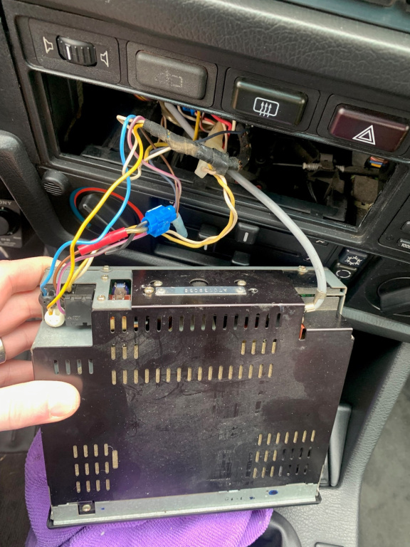

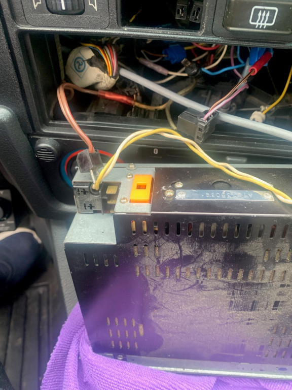

    I recently picked up an 87 vert with the factory head unit. When I bought the car, the previous owner says a sub was removed from the car and the headunit was never reconnected. The car has an aftermarket period correct blaupunkt 80W 4 channel amp mounted and connected (at least from what I can tell looking at the amp). The car has the factory premium sound system and stock speakers. I took a shot at putting it together based on what I could find doing a search. I was able to get the power sorted and everything works aside from sound and the antenna (kind of important parts of a sound system). The lighting, memory, dimming and all that works, just no sound/antenna. Here are some pics of the back of the unit as i have it wired up now. There is a small space for an antenna connection near the power connection but there isn't a corresponding connector that would fit there. Also, the brown connection doesn't have a place to go so i taped it for now. If anyone has suggestions I'd love to hear them. Also, isn't there supposed to be a ground that goes in that hold in the middle? It didn't have a screw/not in the hole to secure a ground and I don't see an obvious ground wire.

    The brown wire with 2 prongs seen below is the one I cant figure where to put. This is what i saw the first time I took the unit out
Name:	unwired radio.jpg
    This is where I landed with my wiring. Not pictured is the fuse reinstalled but that got it turned on minus sound.
Name:	radio wired 2.jpg

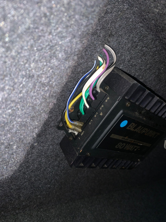

    Here's the amp wiring

ID:	10088784 Click image for larger version
