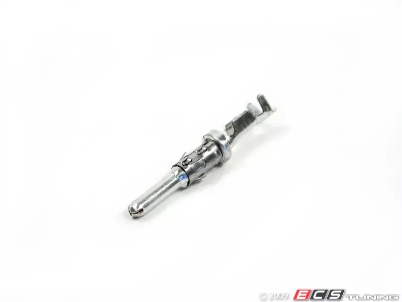

    BMW Pin for reference:
    ​Click image for larger version

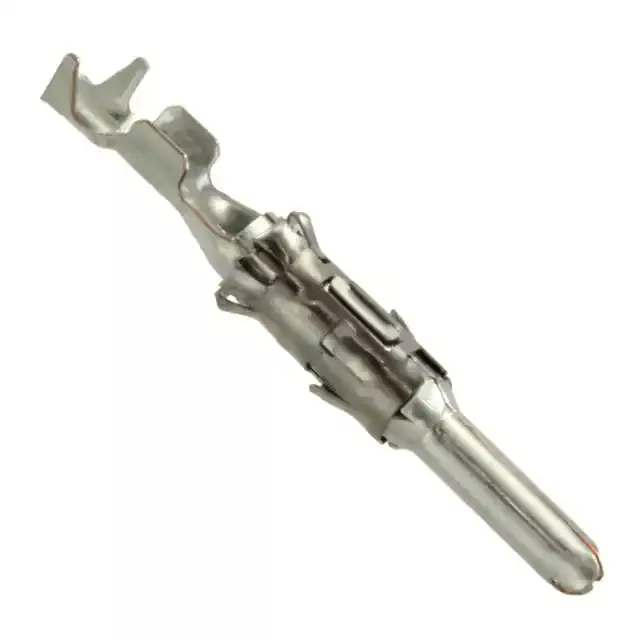

    ITT Cannon Pin:
