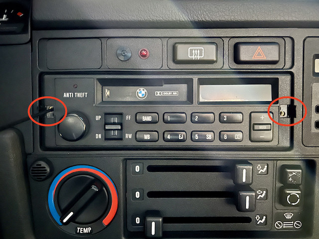

    Step two: Flip out the little doors covering the screws and use the allen key to turn. These screws do not hold the radio in directly. Instead, they deploy tabs on the sides that wedge the radio in place. Do not expect to remove them.

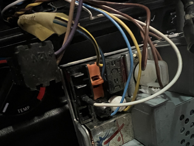

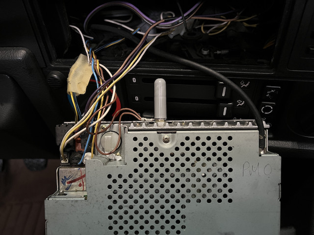

    Step three: Disconnect all of the cables at the back of the radio to remove the unit. Take photos to make sure you can remember where the cables connect. Move to your workbench.

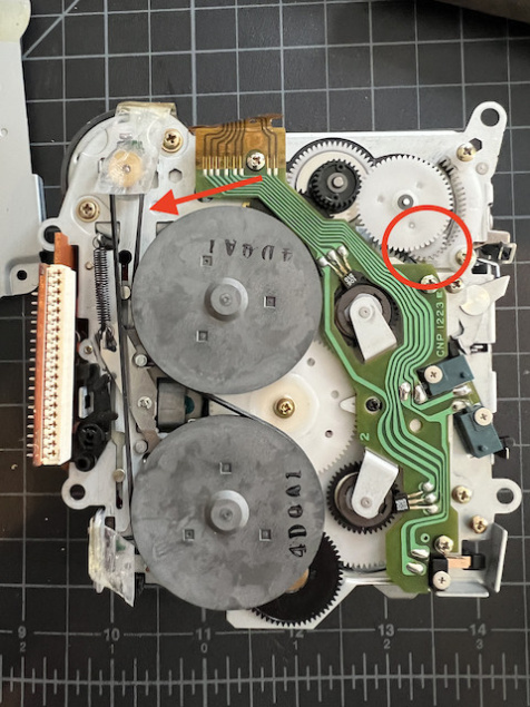

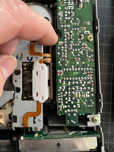

    Step six: Flip the tape mechanism over to the right and disconnect the plug (which is on the board I am pointing to)

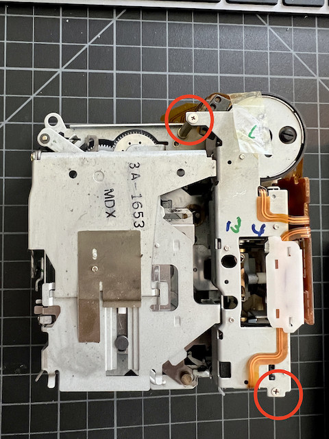

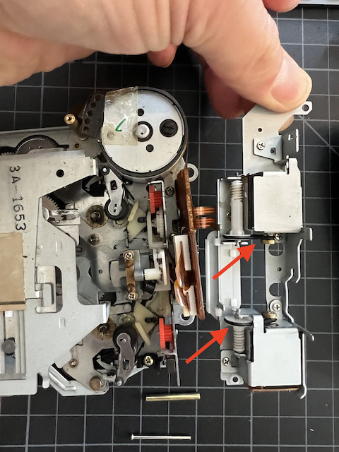

    Step seven: To access the drive belts, remove the two screws circled and flip over this section of the tape player. The two small belts (arrows) drive a pair of worm gears. The shafts on which these rotate can be pried out without much force. Replace the old, dry belts and reassemble this part of the tape player ensuring that the worm gears seat properly.

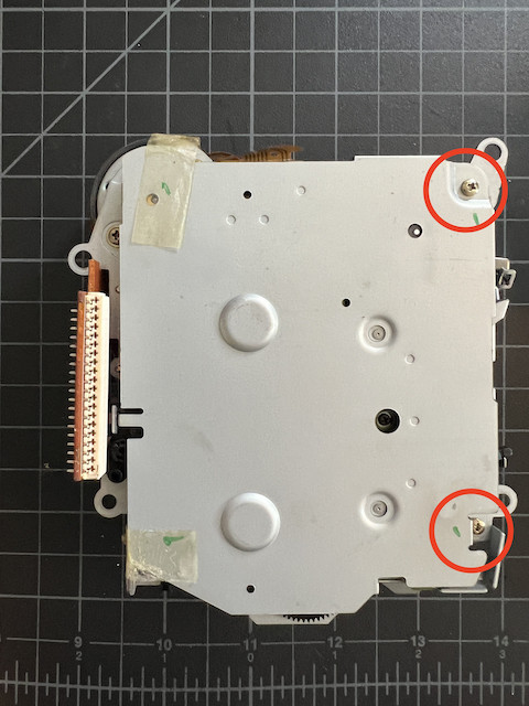

    Step eight: Flip the cassette mechanism over to reveal the two screws holding the back cover on. Underneath, you'll find the load/eject mechanism. Simply remove the old belt and replace with the new. I'm not sure it mattered, but I made sure to drive the mechanism to the fully ejected position for reassembly (note the position of the small gear circled).
