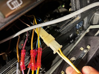

      Click image for larger version  Name:	IMG_6616.jpg Views:	0 Size:	34.6 KB ID:	10124090 Click image for larger version  Name:	IMG_6623.jpg Views:	0 Size:	38.5 KB ID:	10124091
      Massively appreciate the help, for anyone else in the future that skinny connector is C215 (behind the radio), that white one with the large blue wire coming out of it is C302 (under the kick panel, to the left of the pedal assembly). For whatever reason the previous owner had cut the Rd/Gn wire from c302 to c215 just a couple of inches from the connector, if i had to guess probably while installing previously mentioned aftermarket radio. Radio works great now, remembers saved radio stations and does not require code on startup anymore.
