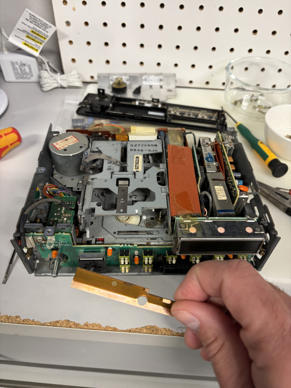

    I was working on replacing the capacitors on my CM5908 when this fell out of it. Any idea where it goes? Im stumped.

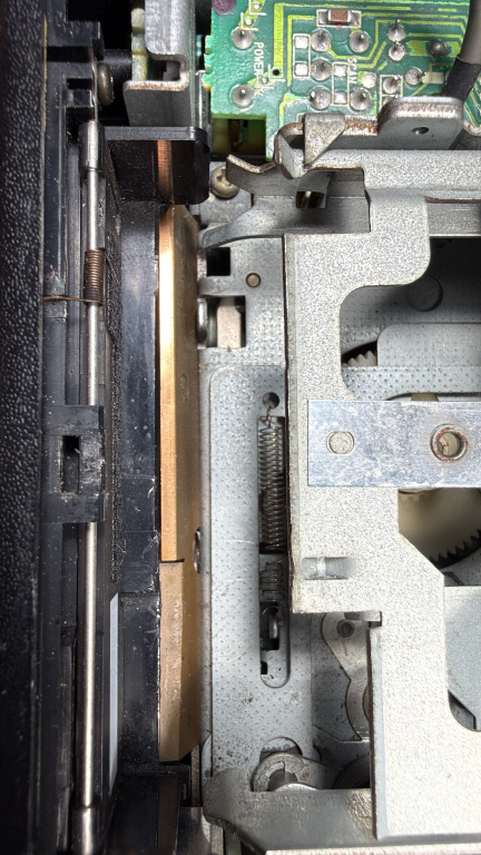

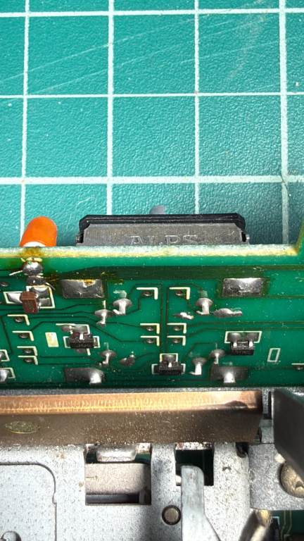

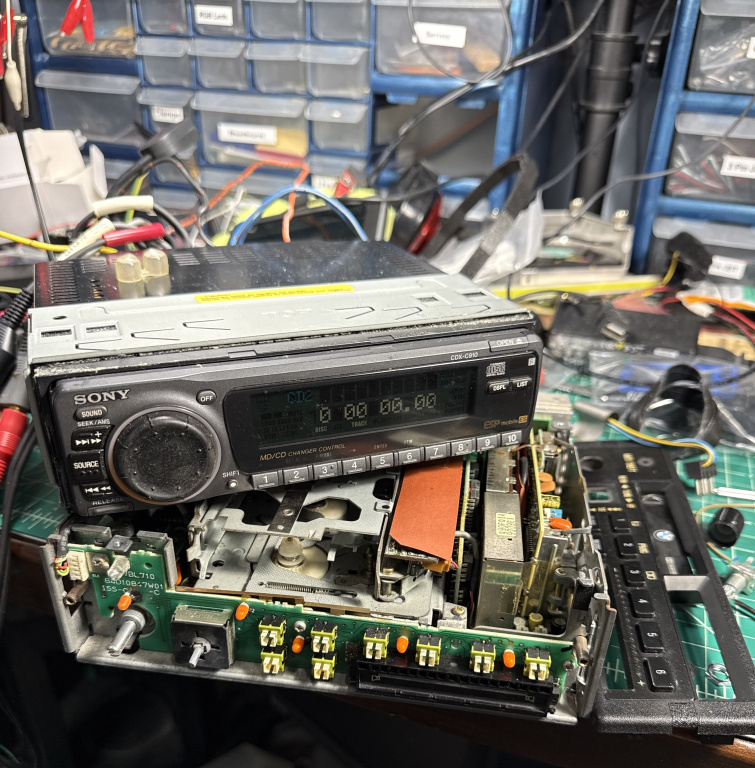

    i just put mine back together last week. I did find some photos that may help. Basically, it goes behind the front circuit board/faceplate, in a slot between the front of the cassette assembly. With the angle facing forward and the tabs over the circuit board.
    Click image for larger version  Name:	IMG_3947.jpg Views:	0 Size:	213.2 KB ID:	10154223 Click image for larger version  Name:	IMG_4069.jpg Views:	0 Size:	193.9 KB ID:	10154224 Click image for larger version  Name:	IMG_3923.jpg Views:	0 Size:	302.3 KB ID:	10154225
    If that doesn’t help, I can take mine apart again. ​​
