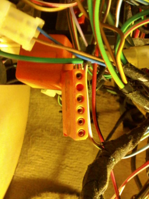

First plug: Orange plug (near the orange relay) with 6 pins-
pin 1 - brown with black stripe
pin 2 - empty
pin 3 - red
pin 4 - purple
pin 5 - black with green stripe
pin 6 - white with black stripe

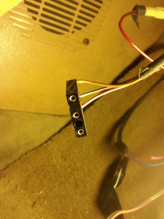

Second plug: Black plug with 4 pins-
pin 1 - red with green stripe
pin 2 - empty
pin 3 - empty
pin 4 - two brown with green stripe wires

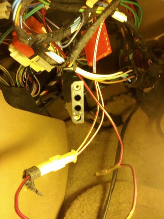

Third plug: Black plug with 4 pins-
pin 1 - brown
pin 2 - brown with blue stripe
pin 3 - empty
pin 4 - red with white stripe

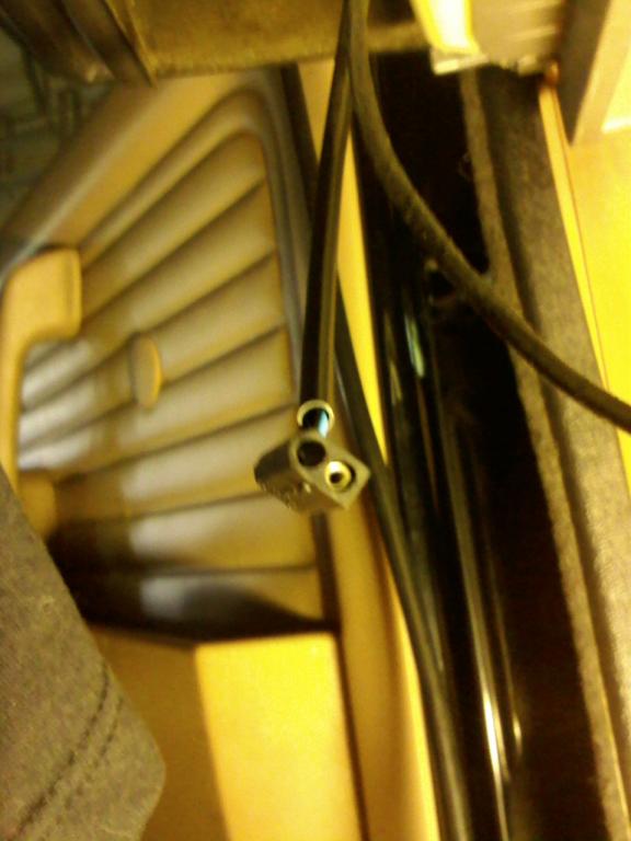

Fourth plug: Black plug with 2 pins
pin 1 - blue with green stripe
pin 2 - empty

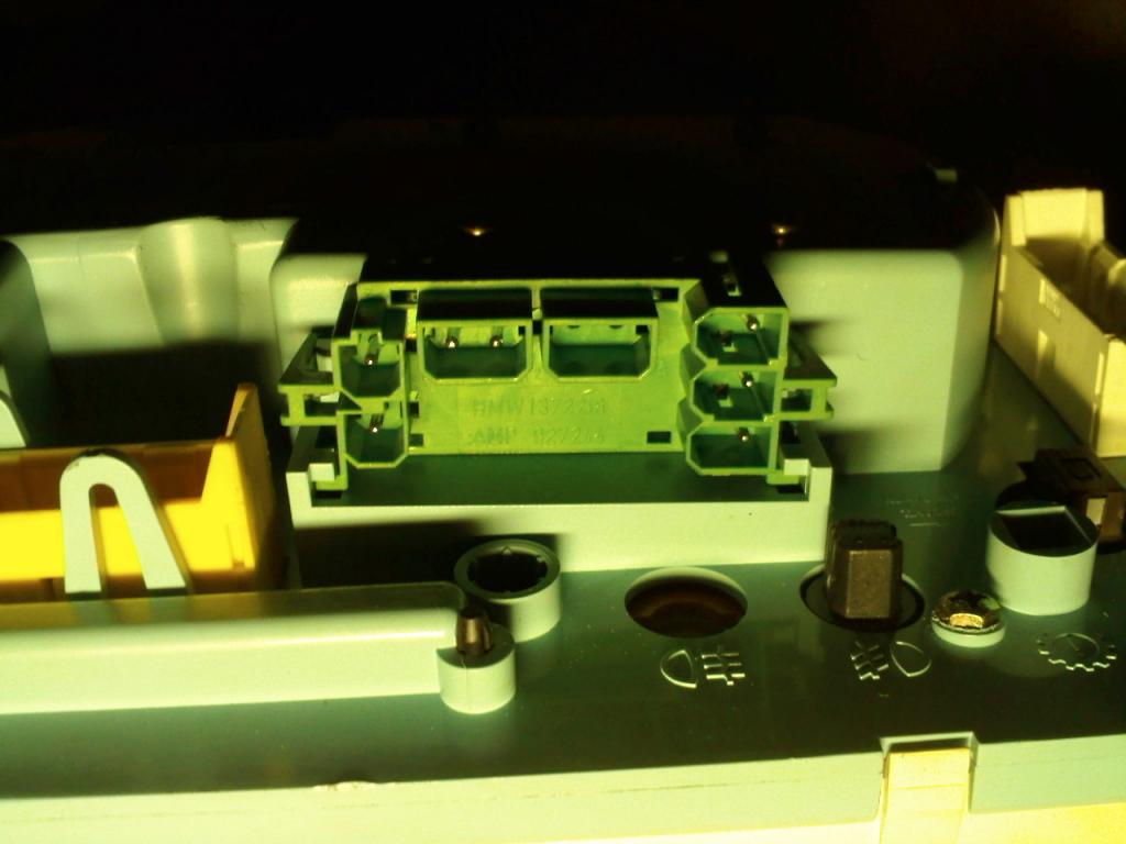

The fourth plug looks like it might go into that green connector behind the cluster that plugs in below the speedometer in the back. There's a picture of that as well.
