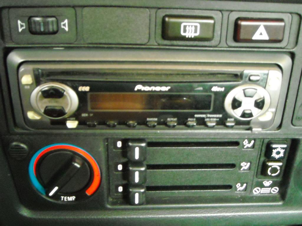

                Thank you so much Luke. I rewired it like you said and it immediately worked. Thanks again. You rock :mrgreen: Here is a picture. I know it isn't exactly flush or even stok looking but it lights up a similar color as the dash, my old deck didn't work so well and it was free!
