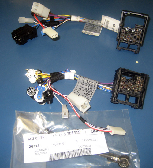

    Which adapter do I need to install a cd43 in a 10/89 built 1990 325is canadian version. do i need the 2 channel or the 4 channel? the car does not have a oem cd changer but there is an oem amp in the trunk.
    i found a picture of the 2 harness and both seem to have plugs that will plug into my car. i just pulled out an after market deck and its a mess in there. please let me know which one i need
    There are two versions
    2 channel - 65 12 8 350 192 -$54 (top)
    4 channel - 65 12 9 410 558 -$43 (bottom)

    I have the same question except for mine being a US Spec car; 1990 325iC with the OE AM/FM/WB/Cassette (the one with the finger-slide for fader etc)

          Easiest answer is if you have the fader you need the 2 channel, if the fader is in the radio use the 4 channel.
          they both use the same antenna adapter.
