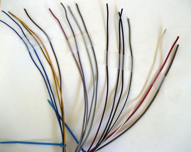

    so Im going to revive this question with my own answers...

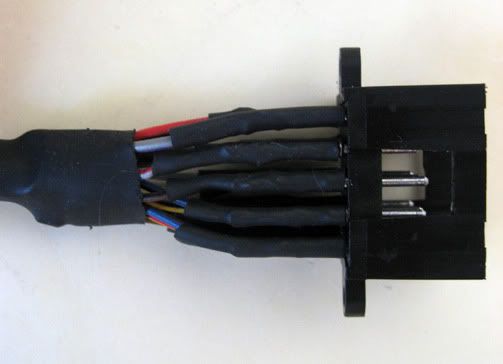

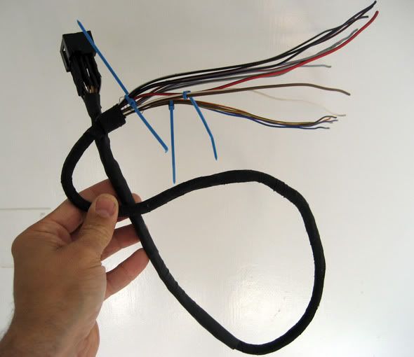

    First I went to PnP and grabbed a trunk harness from another premium sound car.
    Then I broke out the male end in the factory amp and wired it up to match
    So from L to R
    the first group of 4 is the signal from the HU/fader + the common ground
    2nd group of 4 is the +,- for the fronts
    3rd group is the +,- for the rears
    4th group is B+(30a fused), remote, and power ground
    this harness makes wiring an aftermarket active crossover and amp virtually P+P! Im using the B+ to power the crossover and a 10ga + and - for the amp. That is the only new wiring I had to do.
