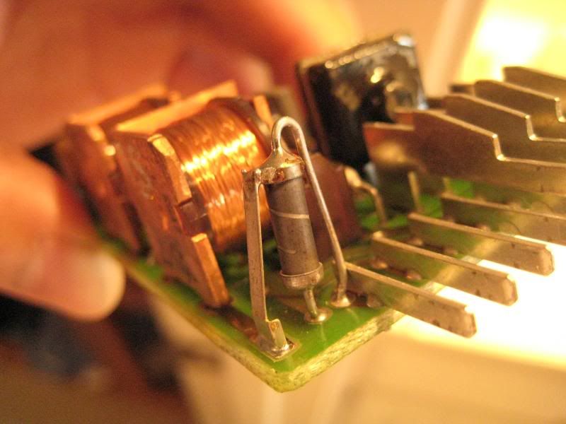

        Thanks M42 Sport, I tried to search, but didn't find this. In that picture did you already solder because I'm seeing nothing wrong with that picture... Hmm time to take my unit out.

              No on the pic I posted the solder had broken. It was kinda a bitch to get to since it was underneath the drivers side front speaker. I got lucky and had a easy fix on mine. Also check the harness running to the door. I read these get rusty sometimes.
