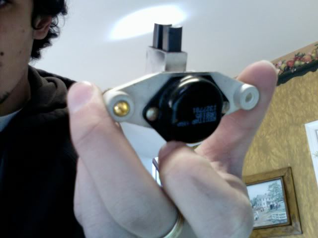

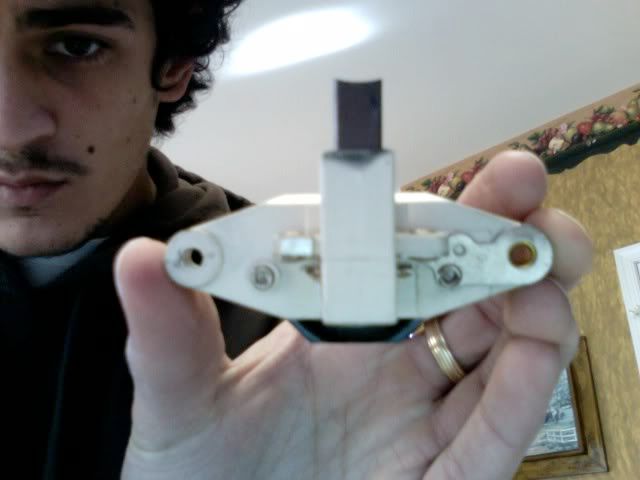

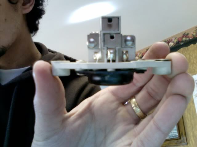

    Took out the voltage regulator and it seems to be in good condition, took pictures just in case someone had something else to say about it:
