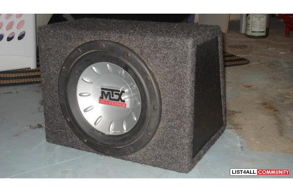

      As for the sub, I haven't had a chance to take it out of the box yet. It just looks like this http://www.list4all.com/www3/click-it/99-2.jpg
          That could be one of about 4 or 5 different woofers. You may have a great candidate for one of my boxes there. No one ever complains about sloppy bass with one of my designs, and if they do it is the wrong specs...you might wanna jump on one with this next round of boxes.
            Luke
            I'll find time to take out the woofer and take a look.
