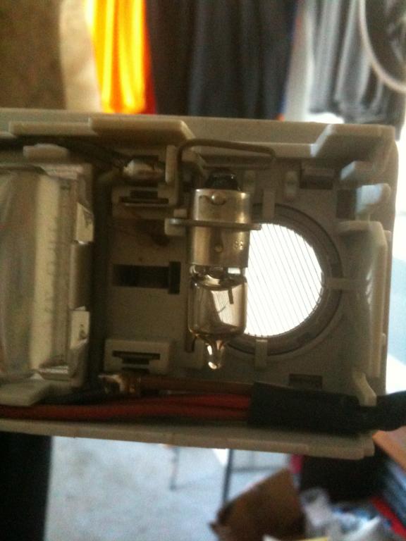

            Bumping this back up - how does one GET to the bulb? Do the little assemblies come out when you stick a screwdriver in the slot? If so I may have to get more energetic.
            • 36brua
              • 689
              yes small screw driver, gently pry /lift opena at the slot, and lt assbly will come out. you have to remove the contacts at the top to remove the lamp. small philips head screw. uses 12v 10 watt mini halogen. easy to do and good time to clean the lenses.
