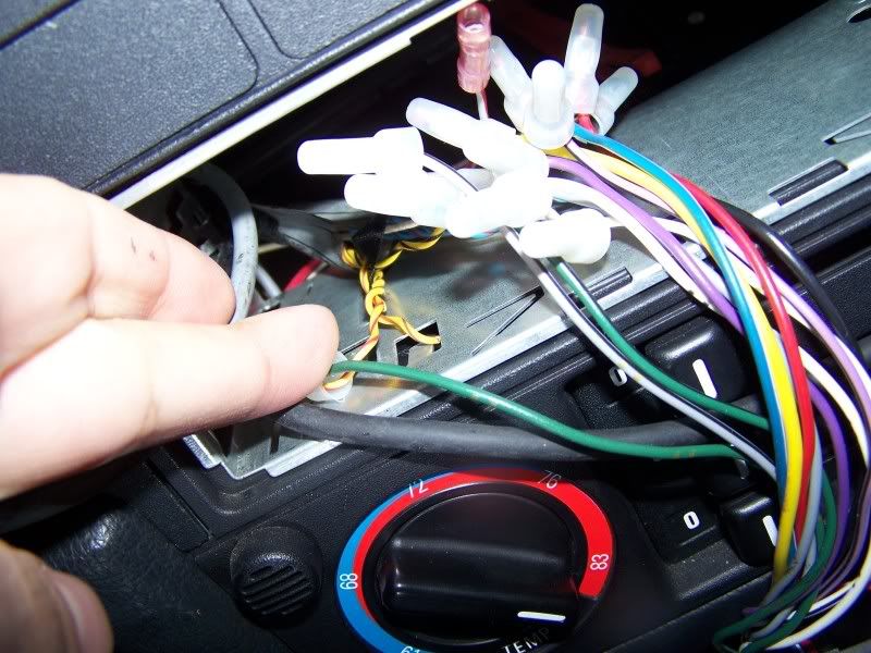

                    • MaloventEvil
                      • 248
                      I was hesitant to show pics because it is very hard to see what is going on....
                      Here is what I got:
                      • StereoInstaller1
                        GAS
                        • 22679
                        Dammit, those pics really don't help, do they?
                        Now we need to know what is in the trunk. That looks like it might be a partial rewire.
